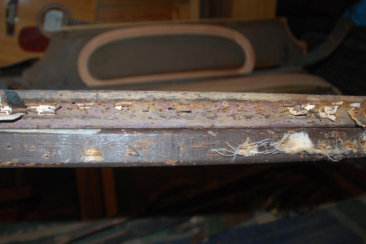

9 years ago
The rear one is grooved on top.
The other one is flat.
9 years ago
Perfect! Thanks Carsten! Just as I expected. The width is basically the same on them. Just slightly different curves.
The HebsterWerks.
9 years ago
I wonder if the wood is somehow made rotproof or just painted?
Any of the cloth or stuffing glued to the wood or is everything stapled to the wooden parts?

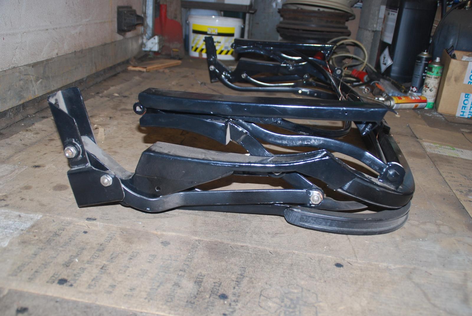

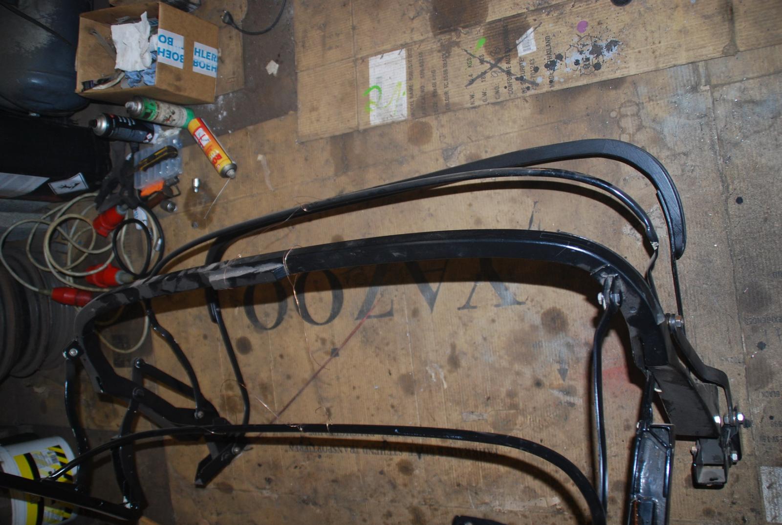

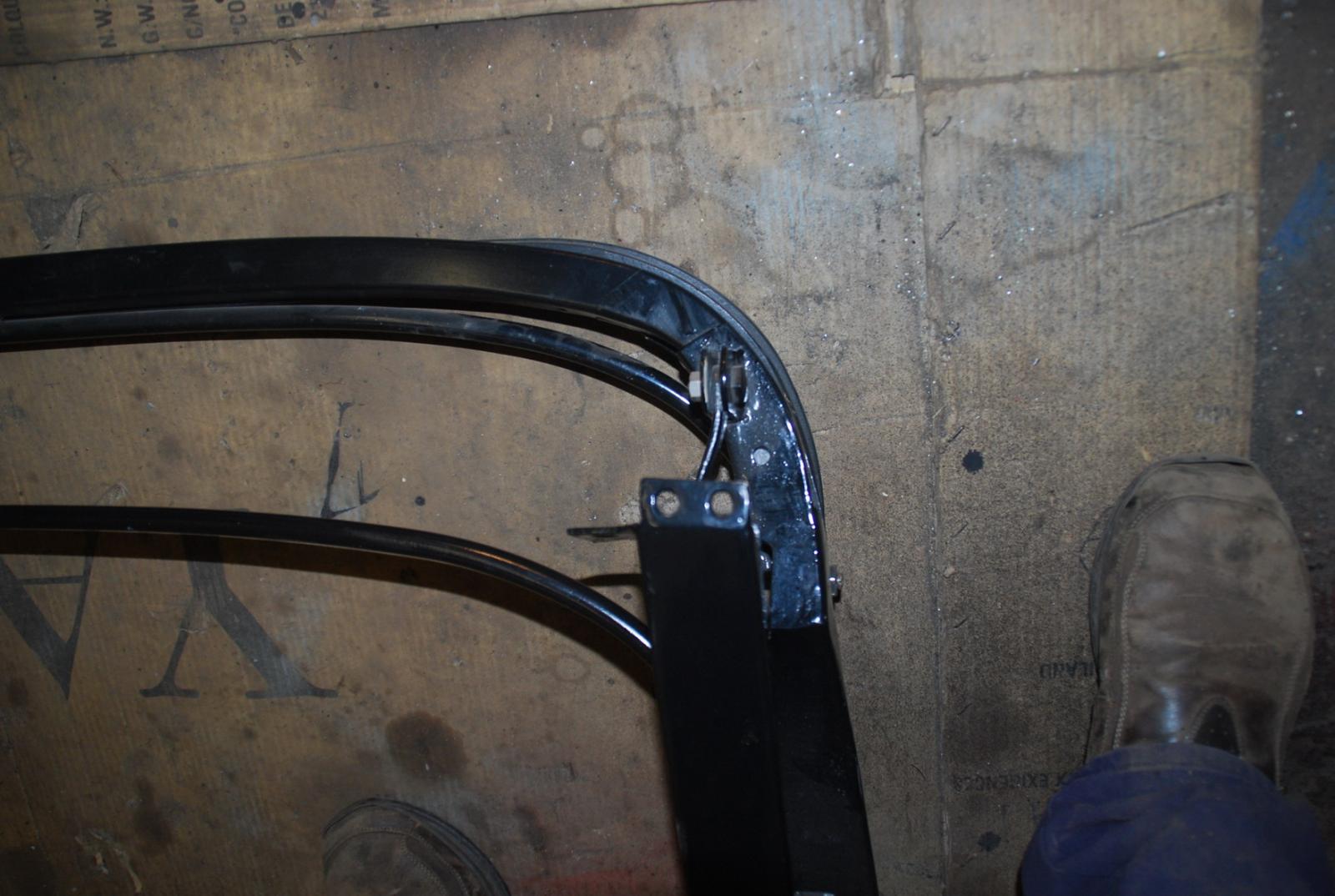

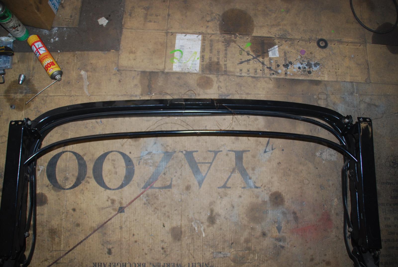

I was at my frame yesterday.
What do you need?
That is one freaking complicated hell of bows and levers.
So glad that I do not have to "make" one.
I made some pics.
9 years ago
Thanks! That does give me some guidelines. Just trying to think ahead so there is less issues later. ๐Ÿ™‚

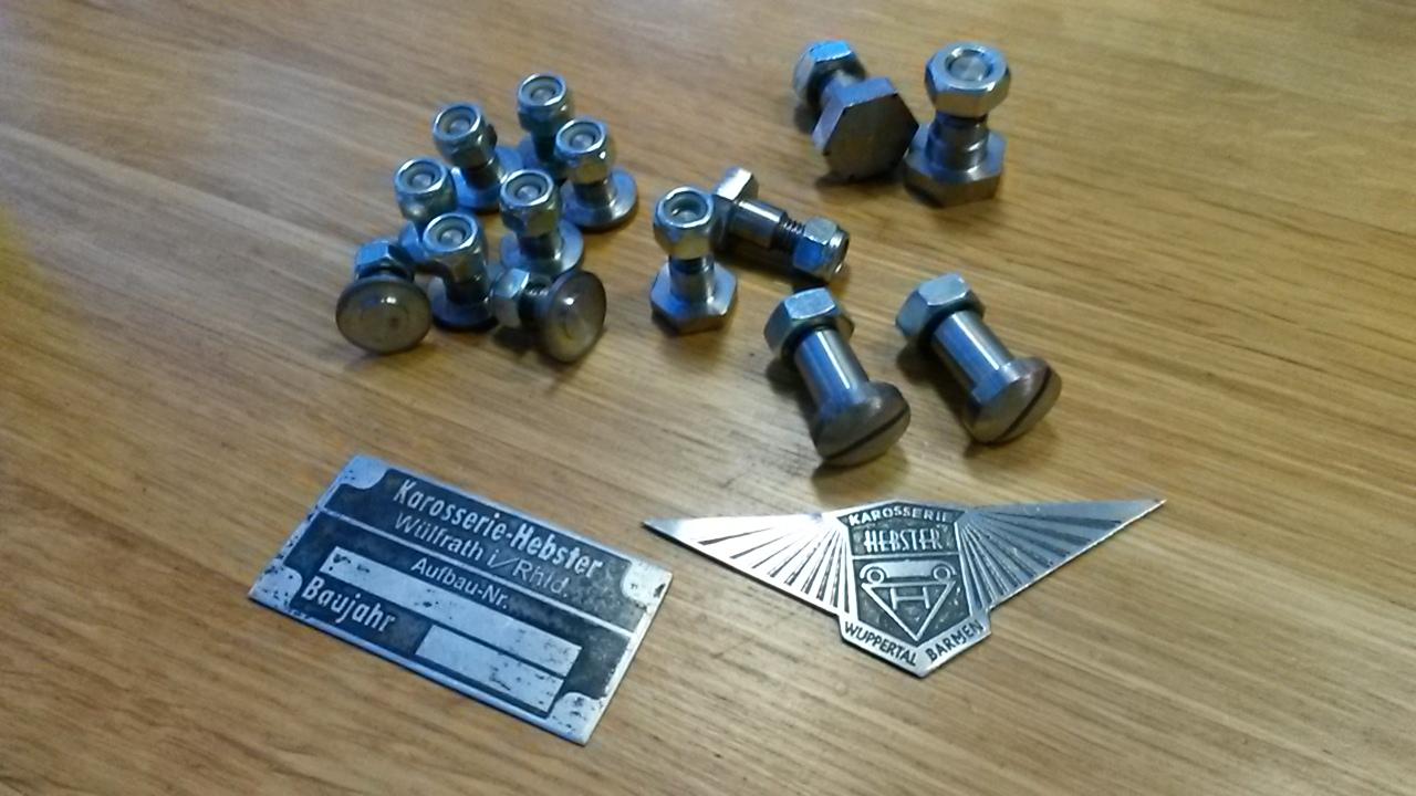

Today I got these from my co-worker from the workshop. Posing with my custom badges.. :)
The HebsterWerks.
