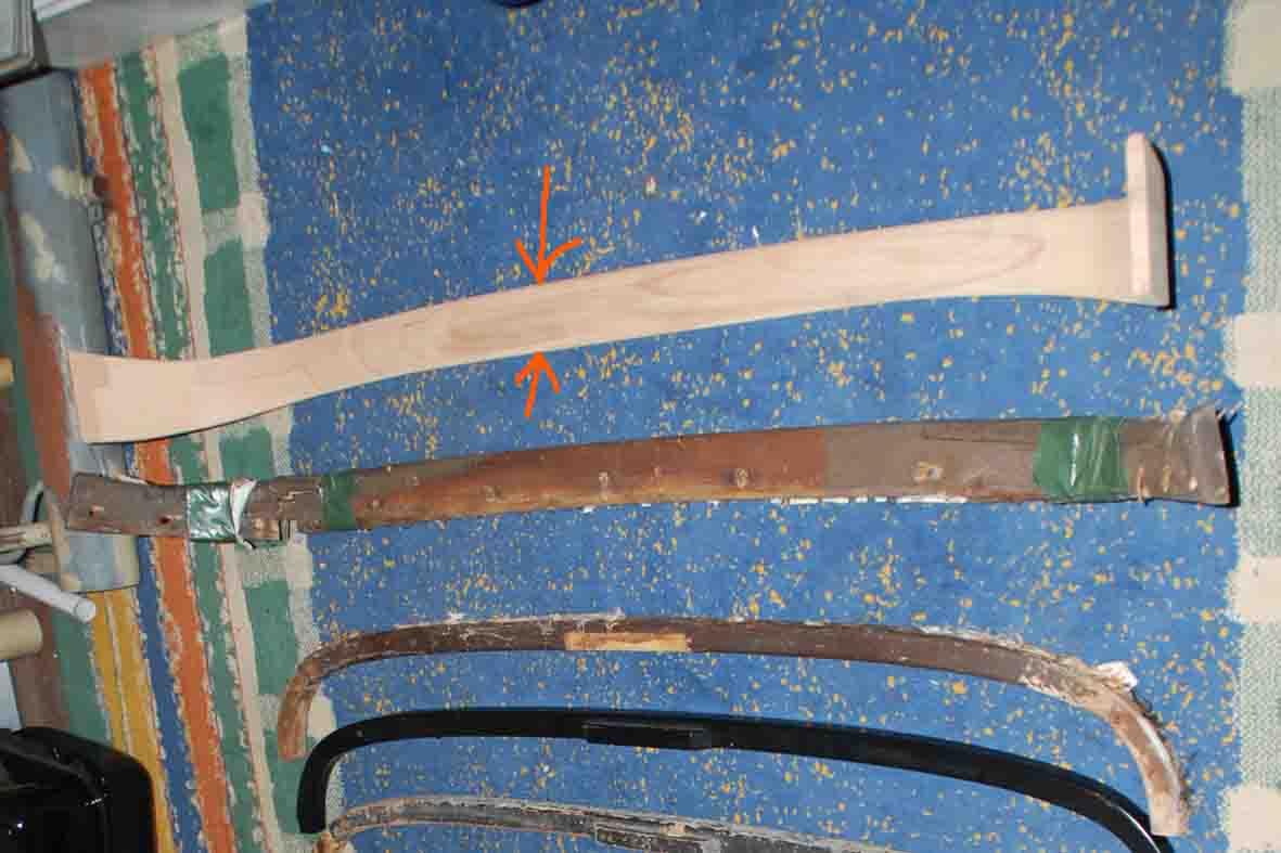

Glued and raw sawed.. 🙂 Now to plane it to 31mm thick and then cut the bow shape.. :)

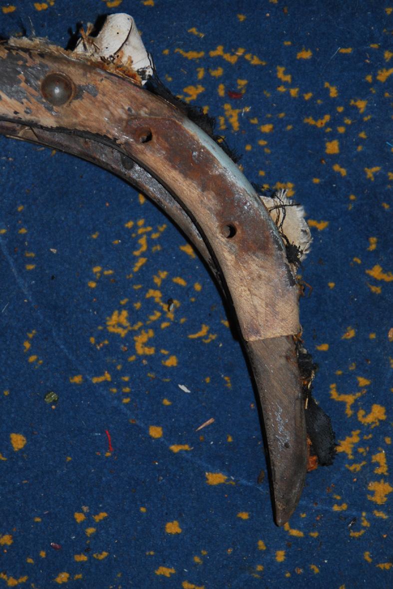

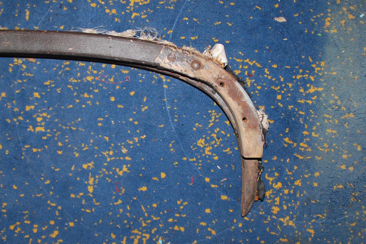

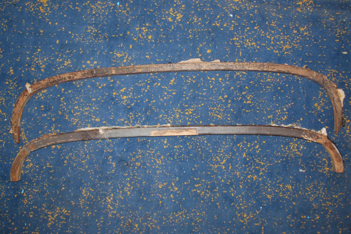

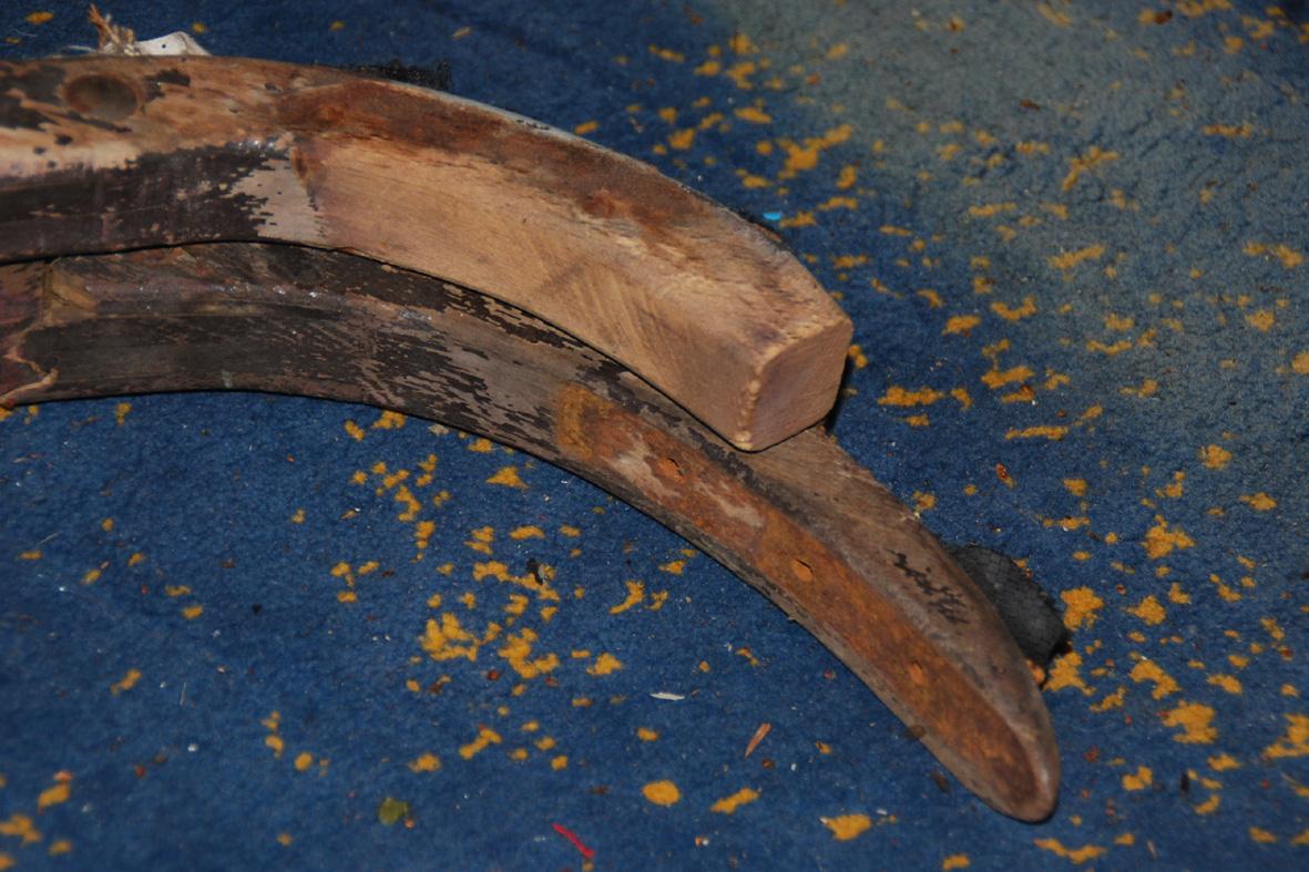

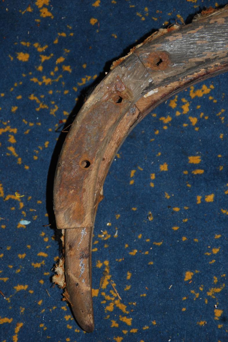

Here we go.
My new ones are already screwed to the metal frame.
I made pics of the old original ones.
