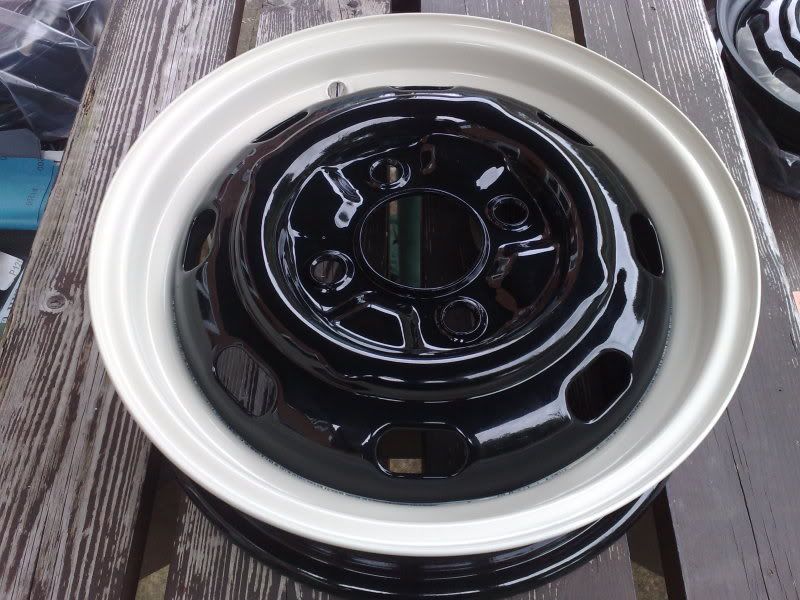

well they are done........
Blasted and powdercoated black
Flatted the rim, and started masking the hub
After 3 coats of Lotus white
Also got a birth certificate for it

those wheels will look very very nice on the car :wink:
thanks guys, going to get the original 67 only hubcaps rechromed and get some new firestones to fit to em 😎

Wheels look great Rob. Going to set her off nicely. :wink:
thanks martin :d

You probably know about this already, but just in case - sand all the paint out of where the wheel bolts go. If you don´t it´ll get squeezed out and you may lose a wheel! And check the tightness of them anyway after a few miles and regularly for a few weeks after that.
Strange to see your car was built in Belgium. Didn´t know they had a plant there.
cool, yer i plan to get busy with the dremel in the wheel bolt recess :)
thanks 😎

well the front two are on!
just waiting for my handbrake cables, so i can finish the rear......
well pleased with them 😎 and the 165s look alot better then then worn 155s that were on before :d
its done! after modding some handbrake cables to work (one year only cables)
do i get a gold star?! :d
Two gold stars I should say. Very nice!!
