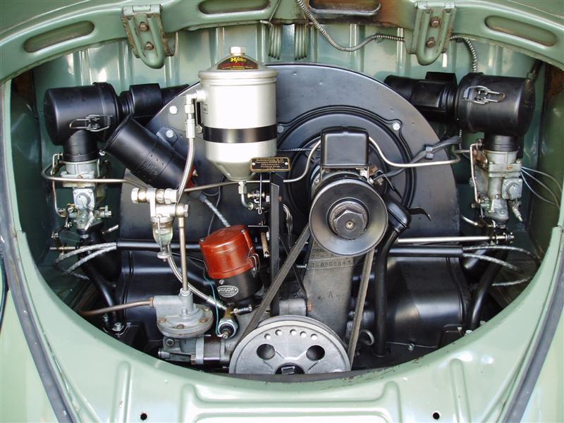

Works very good for mee, Express kit
Nice! I haven't heard of the Express kit, but it looks great.

My Riechert kit turned up in the post this morning. 😎
Just waiting for a few more bits and the car will be off to the workshop for a much needed R+R session.
"JD" wrote:
Do you mind me asking how much the kit cost you all in?
Not at all Mike - it was 392 euros and three cents, plus a tenner for a used 28PCI that I picked up elsewhere.
Its a very complete kit though, including rebuild kits for both carbs, correct jets, and as far as I can see, every jubilee clip and piece of hose that you'll need for the job.
The only thing I'm not wild about - and its a very small niggle - is that the air filters are shiney stainless. I may paint them black or get them blasted to matt finish.
Well, they are on there and performance wise its quite an improvement. I don´t have to change down ro third on the autobahn any more (though only just!). Unfortunately the linkage was rather poorly fitted and I´m not getting anything like full throttle opening. Will piss about with it and see what I can come up with. Strange that my accelerator pedal only seems to have about two inches of travel anyway. Is something wrong do you think?

Peter_Plade wrote:
It was always a bit short on travel at the pedal, but I never really thought it might be a problem until now. Maybe its meant to be like that, but it isn´t helping me get full opening at the carbs. Maybe something is bent somewhere.:?
I will take a picture, but I can´t do it for a few days. Its all a bit bright and shiney looking compared to the rest of the motor - I think I will spray it all black, try to get the stainless air filters blasted and fit some button headed bolts. It won´t take much to "age" the look of it all.
