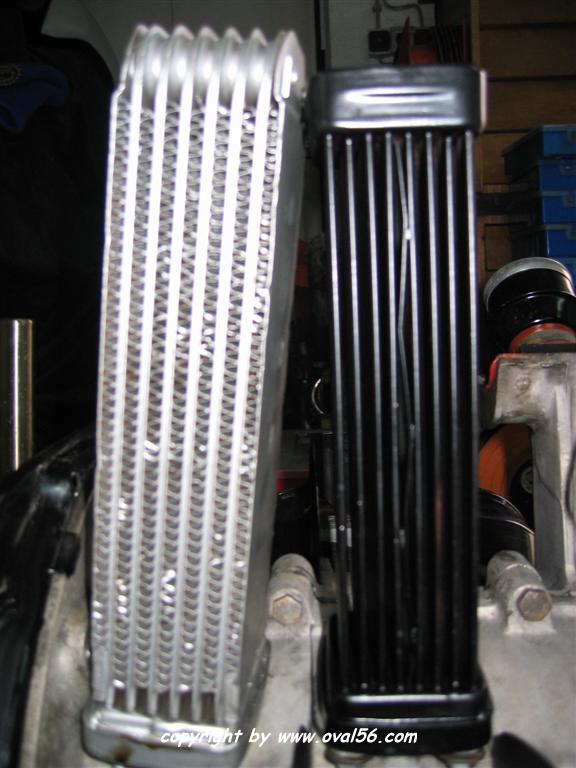

You would think fitting the more efficient 912/356 Cooler would be a simple fix. Yes they do physically fit with a little tapping of the top of the fanshroud as they are slightly taller.
The thing is because they channel away more heat, whilst they lower oil temperatures, they also raise head temperatures for two reasons. The first because as I say they channel more heat away but blow this over number 3 cylinder and they cast a larger "shadow" than the stock cooler which has always been a problem with number 3.

for information, i do had my kinds of external and internal oilcooling systems on my 36hp engines but to the 912 or 356 cooler i can tell some good and bad things...
if your maxium driving speed will not rise, or better if you drife not faster than with your original engine, you can use it, the temperature is about 10degrees cooler as with teh original one..
BUT the air circulation on the 3. cylinder is even worser than with the stock oilcooler!

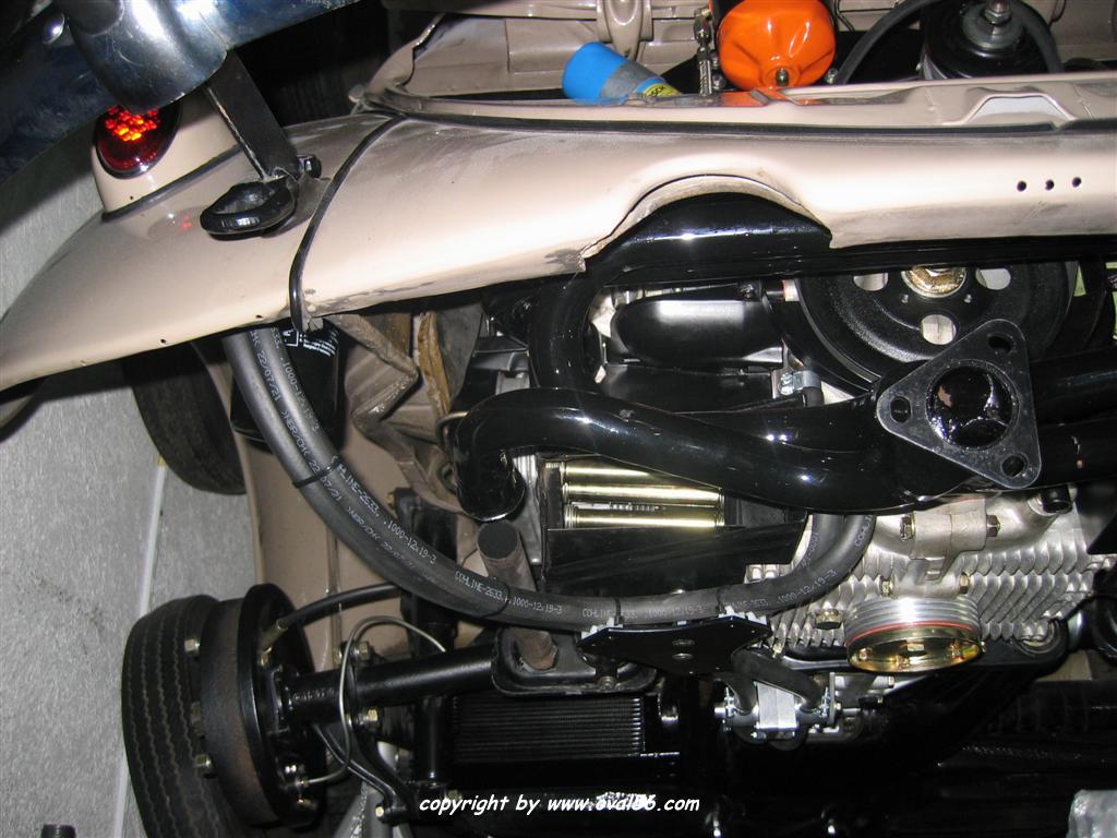

here is a result of my 57 rat i owned, wich also had a 36hp dualcarb engien with some modifications ( higher compression, bigger valves...) so in end i got back to stock oilcooling, and this worked also fine
