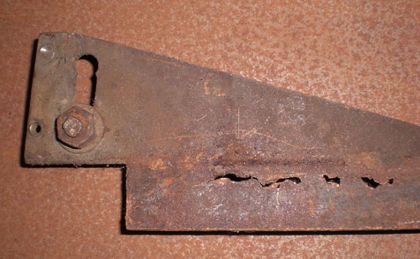

Question 1. Does anybody know if the window stopper shall look like this?
Question 2. Have anyone of you replaced the window channel inside the door with any other material?
I was thinking about some kind of teflon.
Thomas  window stopper.JPG You have insufficient rights to see the content.  window stopper2.JPG You have insufficient rights to see the content.
Thomas
Sambaguy wrote:
Thomas,
question 1 I don't know ! They where missing in Et's car!
question 2 Yes we decided also to use teflon !
Guido:wink:
These where at mine. Somewhen around oktober 1949. Maybe they changed them to your style later.
These bolts/screws adjust the endpoint of the window movement.
usariemen wrote:
Same as mine Januari 1950.
Sambaguy
Thank you guys!
Mines are probably home made. Just wondering what they are supposed to stop against.
Maybe if some parts in the door of mine Heb were worned, they replaced it with bigger "stoppers".
Hello, Sambaguy
I think, my opinion, that the round ones are early and later replaced with nut and bolt...
I see it in the first platce in economic way.
The nut and bolt could be taken from the shelf. The round part has to be made on a lath.
secondly, it more a mechaniker solution: to adjust the nut and bolt you have to use 2 wrenches, to adjust the round part you need a plier or a vise-grip.I do not see a flat part to hold the round part.
Maybe when dismantled it could be that on the side where it meets the frame, there are 2 flanges that fit in the slot from the frame part.
If that is the case, you have originals and with that thin slot, the flanges can be easy damadged caused by overturning when rust is there.
Think like the square bolts in a bumper...after a few years they easy break the corners out.
I should dismantle the round part to see what is on the side of the metal.
Greetings.
