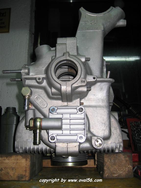

is it worth full flowing a 36hp crankcase?
if it is, where do i tap the oil galleries?
what size tap and fittings?
or should i just leave well alone ?[-x

i think it is a way better than useing a by pass filter and dropping the oilpresure with it
i got fittings from my local hydraulic store, but on thesamba.com at the vintage speed section in forums there is also a thread regarding fullflow on 36hp, where somone said that gene berg provides all you need for a 36hp full flow kit.
here it is:https://www.thesamba.com/vw/forum/viewtopic.php?t=370863
