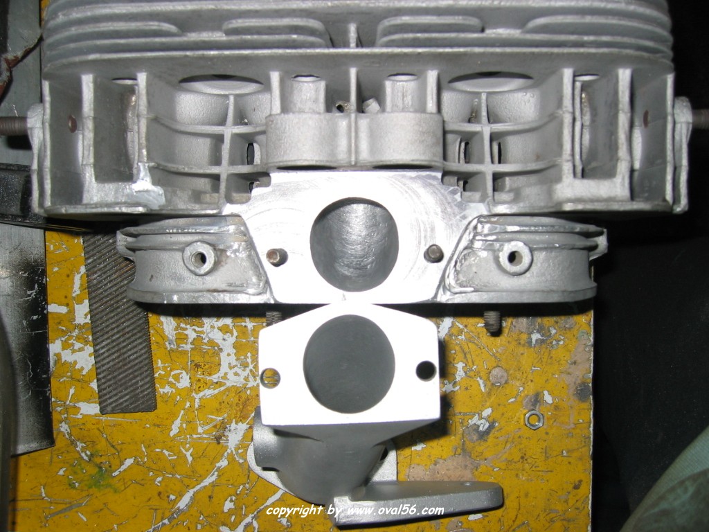

Anyone know what these are?
Look closer 😳
 img_0515-01.jpg You have insufficient rights to see the content.
Okrasa with ported holes for the intake?
Bengt H
Looks like Okrasa but after looking closer I think it could beee welded up originals?? :beer: :beer:
Bengt H wrote:
yes, would i say also.. welded originals
more pictures about this projekt??
the oly question i would have is how can they be fixed on top (two upper inner bolts?)

lou cypher wrote:
mhhhh good post, but as you see on wolfgangs smilie it was an ironic post - wich should only tell that some other guys have tried to start a project like you have finished....
but one think, i do not really understand... it's the fact of the oldspeed spirit. i think that the modifications on original heads due to a welding session and a big amount of grinding hours will bring you only to the point where okrasaheads start (beside some modifications on the manifoldflange geometry). so the fact that WW is building nice quality heads in okrasa style will also support the sentence "The whole point of oldspeed is to use your imagination a little and think outside the box"
so for me the WW heads are really good to start at this point and build my customhead with this basis (bigger valves, some porting and some more improvements) but, and that is really important for me, i would never do this on an original okrasa heads... this thing should be used as oettinger has built it.
i appreciate your work, but i do not understand the discrepance between "using only original parts" ,"NOT using repro parts" but building "own custom solutions"...where (beside the money an time) is the difference if you modify repro parts???
just my 2 cents...

lou cypher wrote:
okay, sounds a bit better for me, i do understnad the olspeed spirt, but for it is really difficult du get a line between where "real" oldspeed stops and "new" oldspeed is beginning, for sure with the repro heads i will start from th eother side of the line and try some new things...
yes you are right, the fines are not the same as original style, they look more than late 36hp heads but as i think it is a good step to start
i had also the opportunity to start with real okrasa castings (nothing pre drilled) but this is a lot of work and a lot of measurement wich i have do do on that heads... maybe nextime if my engine runns well.
back to your heads, how will you do the fixing on the upper middle head bolts?? welding again some tubes in or shouhould the fins keep the force??

yeah they were single port 30hp heads that we modified here you can see before and after
once we made the first set, pictured at the beginning of the post, we used them as a master to measure everything so we could make a pair for use :lol:
and the work continues   30hp_OOCRASA.jpg You have insufficient rights to see the content.

lou cypher wrote:
:beer: :d :wink:
when i see your pictures, i have many hours of welding and grinding and machining in my heads :wink: but th eresult makes that worth:beer: :!:
so the improvmet to okrasa heads is smaller valeshafts, smaller sparkplug thread and bigger valves or? if, what size have you choosen and have you modified the combustion space also? (spherical?? - i had done this to my 1433xx engine)
did you modify the rockerarm ratio also? (different styles / solutions possible)

Yeah I know you have many hours of work on your heads too, but when it's your own time it's for free and the end results are much more pleasing :d
that's right for the heads, bigger valves, smaller valve stems, smaller spark plug
for the rest NOS alu case line bored to 1st over on the case, s90 cam - then of course we need to bin the pushrods and use lifters, preA Hirth crank - yeah we know they don't oil at low rpm's but we are going to drive it :twisted:
we originally planned to use 912 rods with 20mm bushing, 78mm pistons - 28mm compresion height, so the camber is CC'd to 42 to give 8.5:1 compression at standard deck height and 1414cc.
BUT now we are thinking to use either 80mm Nicasils with flat top pistons or 82.5mm nicasils with JE pistons.
912 or carrillo rods
we havn't even got to thinking about rocker arm ratios yet, "The München Boyz" are pushing the envelope on that one:beer: :beer: 8)
nice little movie,:beer: although we had to borrow a "Bill Gates machine" to view it as we couldn't watch it on a MAC :?
we are now thinking about a twin spark conversion :twisted:

If you want a little more peformance from your 30hp or buliding an Okrasa, bore out your standard 77mm cylinders to 78mm
use preA crank (74mm stroke) then you will need to use Porsche rods
now you don't want to use shims, so the solution is a 78mm 323 piston, it has a compression height of 28mm, one problem is that it use's a 20mm wrist pin, that's why you will need to put a 20mm bushing in the rods
Yeah I know people say don't use Mazda pistons, but we have never had a problem with them and I know there are other people using them in their Okrasa's also.
Porsche 80mm PreA nicasils and 82.5mm A nicasils 28mm compression height, no shims required
You don't need to use nicasils just regular iron porsche 80mm & 82.5mm are also good
Nicasil alloy cylinders are not cheap BUT you get better heat dispersion, 917 used nicasils for this reson :twisted:
lou cypher wrote:
lou cypher
but i see, no info on the valvessizes to get :cry:
Oh yeah sorry :oops:
35.5mm intake
32mm exhaust
lou cypher wrote:
You aren´t joking! Nikkies were 3200 dollars when I looked! I bought iron PreA cylinders.
lou cypher
Yeah if your are going to buy new ones with JE pistons then you are going to pay for that :shock:
what you need are used 80mm early preA with flat top pistons and just have them re-nicasiled, although they are not that easy to find 😞
there were a set on the samba a couple of weeks ago for €500, but they sold pretty quickly
