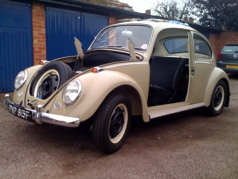

Even with that pic Rob it looks great. More please!
Looking great!
thanks guys, better pic tomorrow in the daylight.

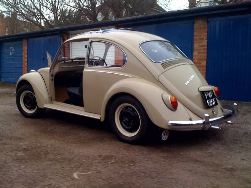

wasnt happy with the dim rear lights, and the indicators were pathetic, so spent some time cleaning up the contacts,and now i have nice bright lights.....well for a 6v.
finish off the front odds and ends next, then its been shipped off to have the doors fitted.

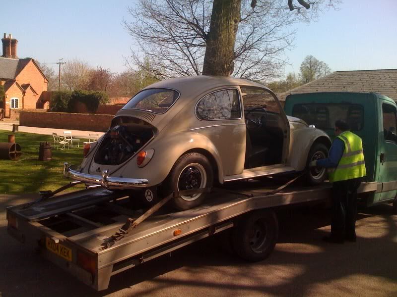

wow looking great, good pics of avoncroft too, on the first pic you can see terry sands california speedster, looking forward to seeing yours

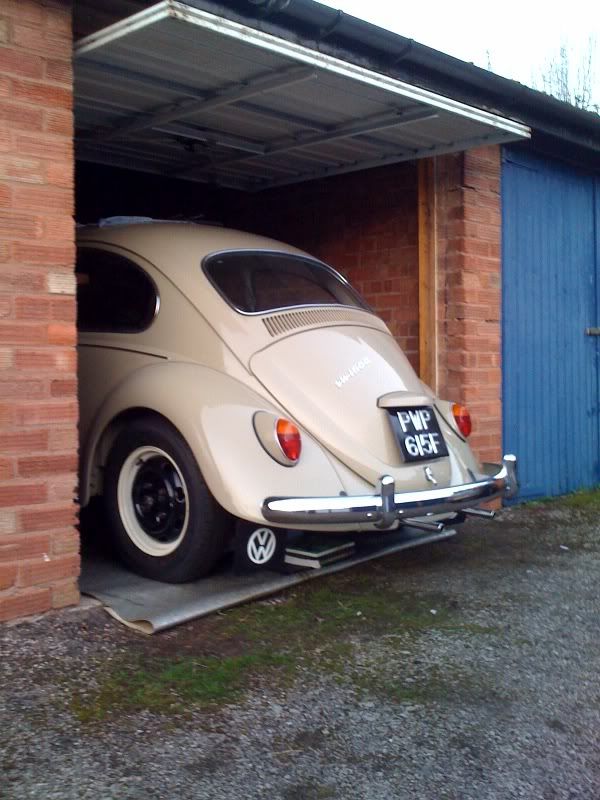

got 5 mins to fill the tank and turn the car round.

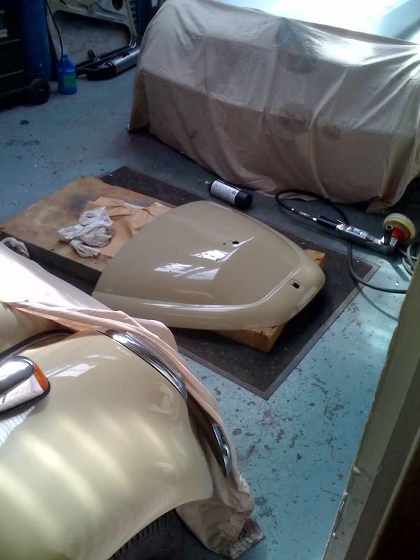

bonnet has been painted will be fitted last.

I finally managed to flick through some of my old show photos today and I have a few pics taken at Avoncroft in the 1990s. Unfortunately, none of your car.
Rich.
oh cool, thanks for looking though Rich, what about my black ragtop? that was there also on silver 356 steels. 😎

Exterior painted! Cant thank Gav enough! made my year! :lol:
The paint will be polished friday ready for its journey up to the midlands on sat 😎
Where did you get those rear bumper mounts from? :omg:
they are original vw metal, cut from a section that Martin has for his ragtop. Gav blasted them clean and then welded in.
I hate repro mounts with a passion :lol:
beefykeefy
Any idea where I can get some from?
Assume your source has no more...?
look on the samba.com, people seem to have some rust free sections cut from cars.
mine came off Martins rear clip he has for his ragtop, as these arent correct for this year of car.
even then Gav had to repair them slightly.

Decklid now repainted inside and out, and like the rest of the car, after appearing to be rust free, the lid had some surface rust under the paint. All sorted now. the hinges, and spring also got repainted
also the doors are progressing, trial fitted here, before the outer door bottom is tacked on
back off to the workshop later to hang the decklid and remove the windscreen.
