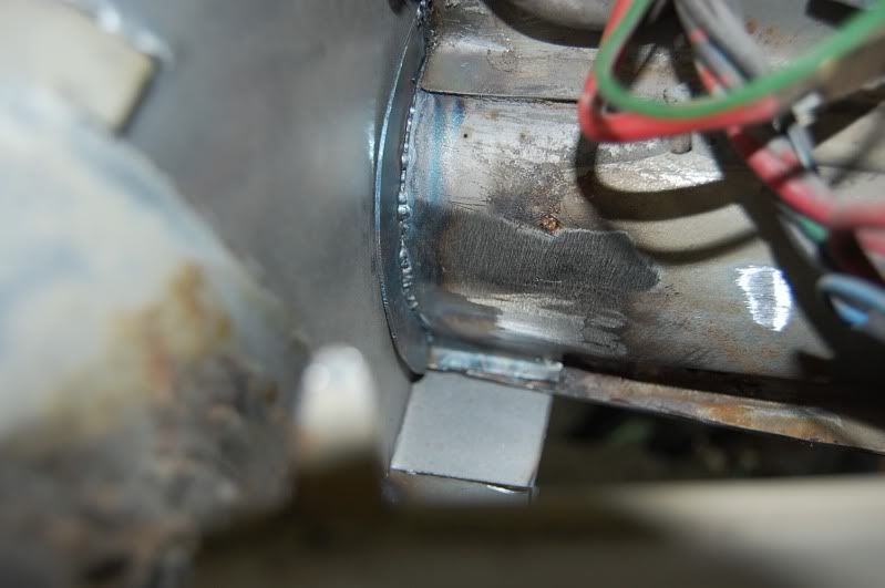

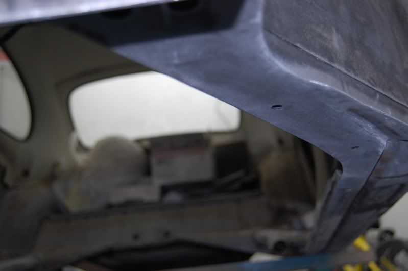

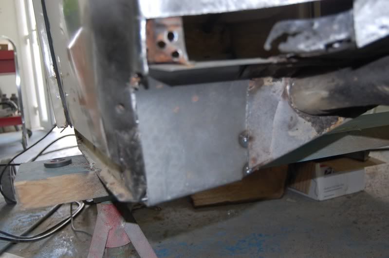

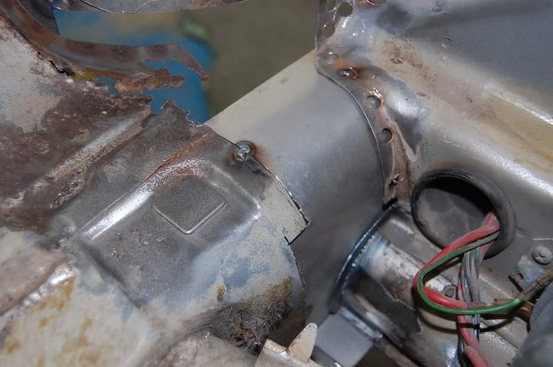

ok, bodywork progress,
before-

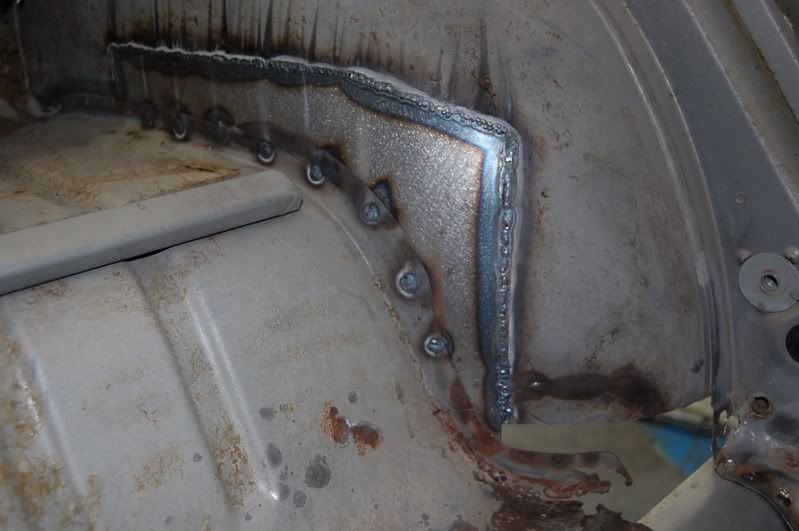

after :d
im super happy! all as factory 😎 more soon 🙂
Now thats welding!:beer:

What he said 😎
That's mighty fine welding :d

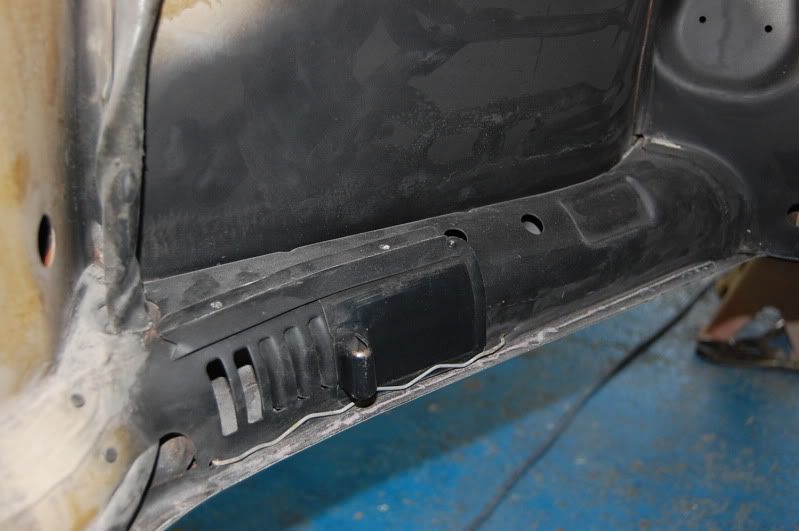

BTW - where do you get those springs from for the heater channel vent covers?
they are the og ones. dont think anyone repro's them.
beefykeefy wrote:
Looks like great work indeed!
Good to see those springs, due to rust in that area in my '65 I did not know how the vent door was held in place until I saw this picture. Thanks!

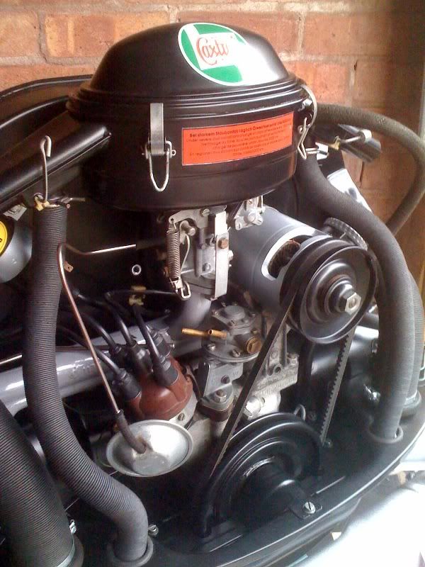

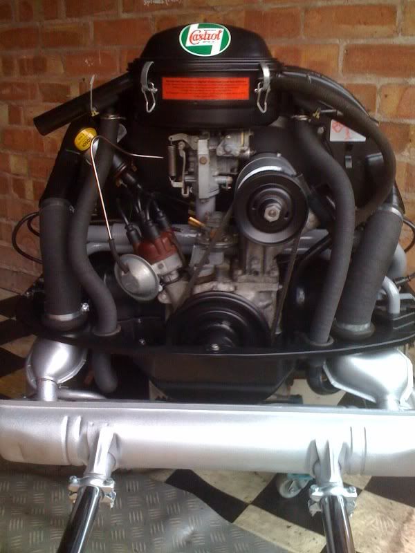

well here is the engine, all factory, reused fastenings, zinc coated generator, powdercoated tinware. Just waiting on the fuel hose to finish.
harveypj
Very nice Robb,
looking forward to seeing your catr all finished.
Stock......the new custom
thanks mate, me too 🙂 hopefully in the next few months 😎

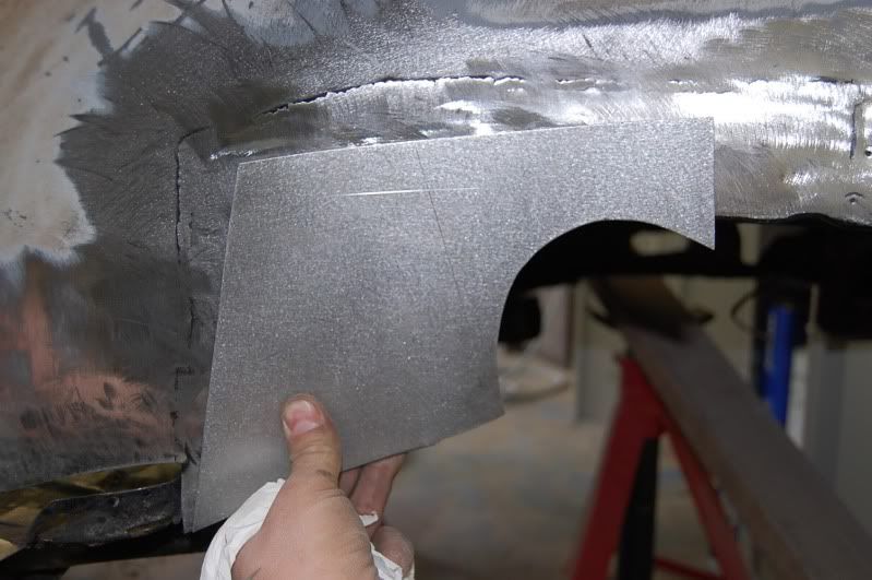

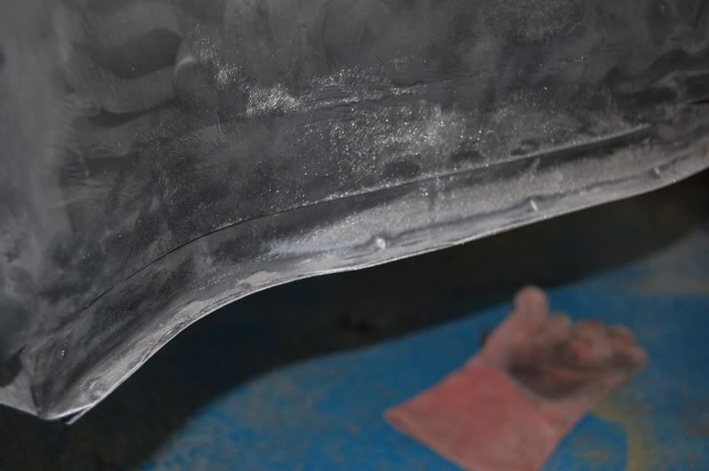

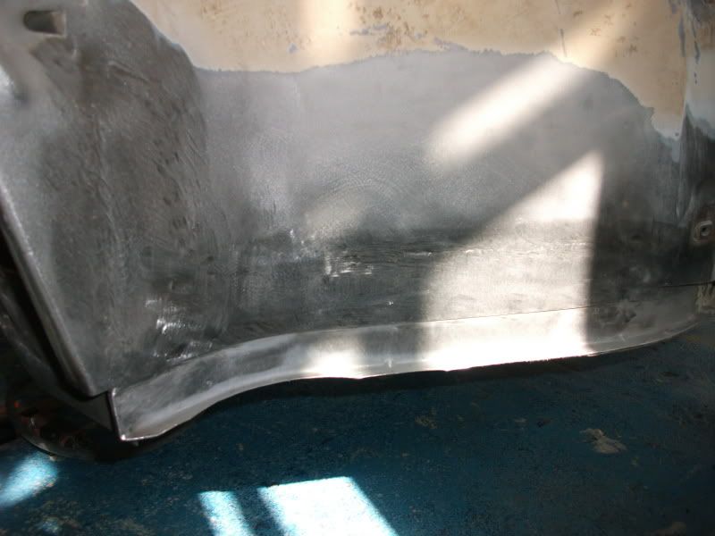

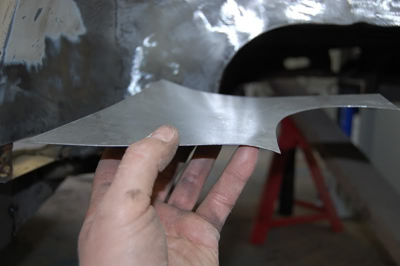

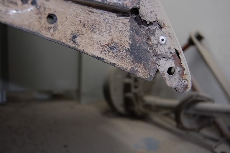

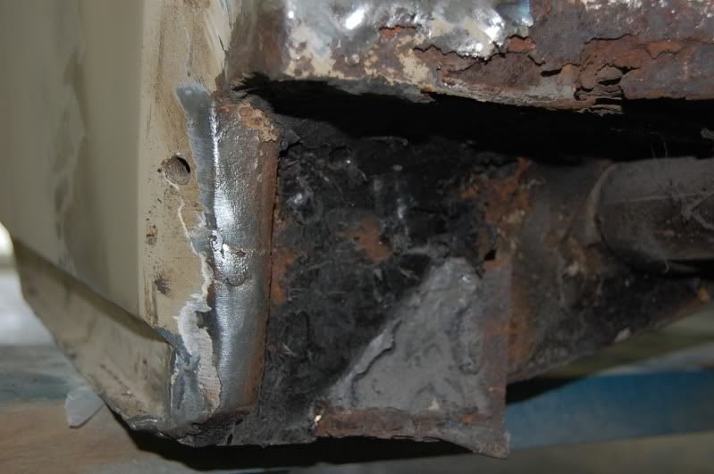

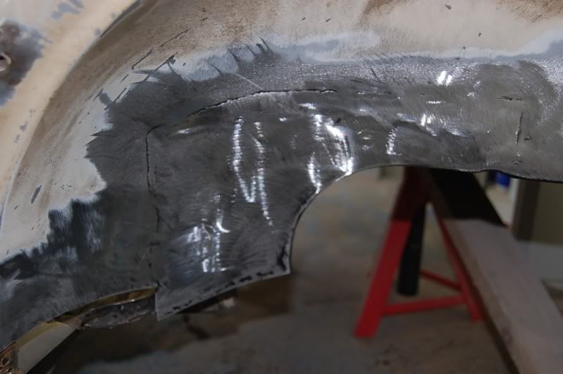

more metalwork photos, this time from the rear wheelarch-
the outer skin with the pressing is yet to be fitted to this-

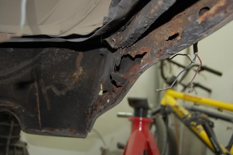

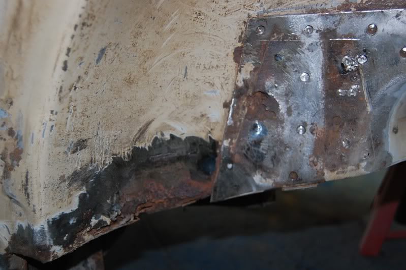

going to replace sections of the rear bumper mounts as Gavin found this-
more soon 😎

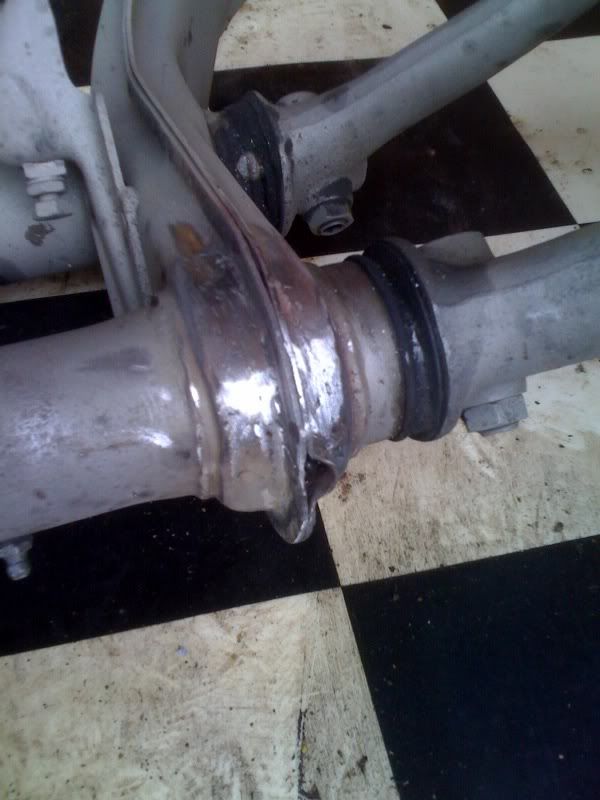

😎 got the beam back last night, another invisible repair, will post pics later
beam all solid again! Thanks to Wayne at the Intergalactic Custom Shop

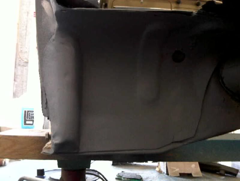

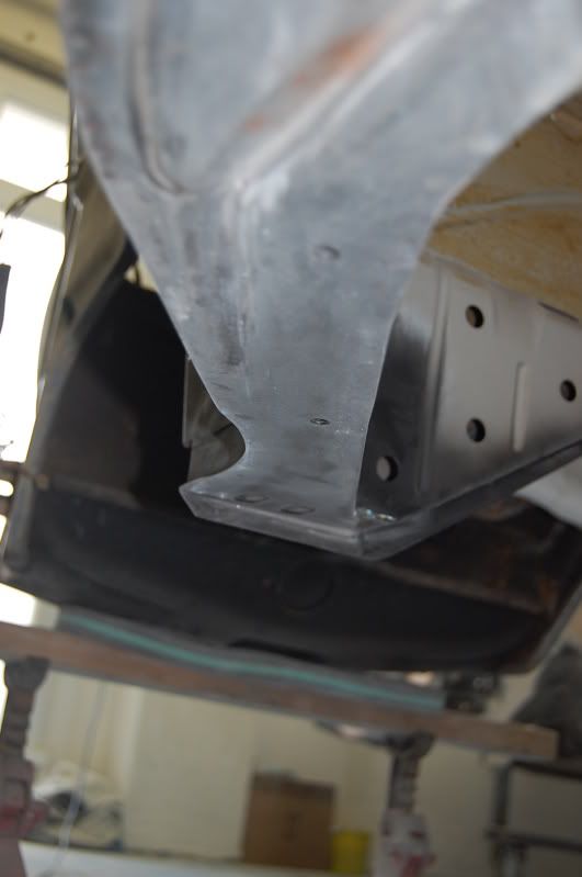

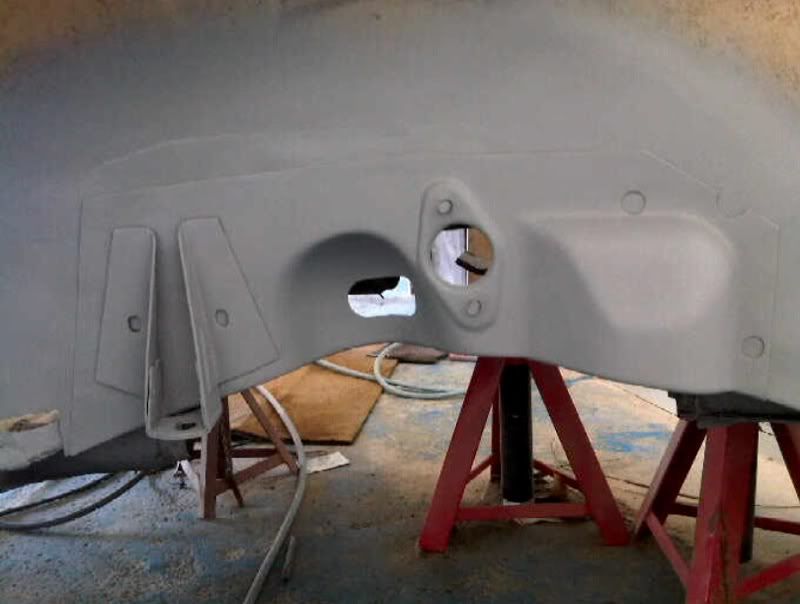

getting there....pass rear inner wing
all panels have been zinc primed between everything
should have the front beam all built up and detailed after the weekend.
