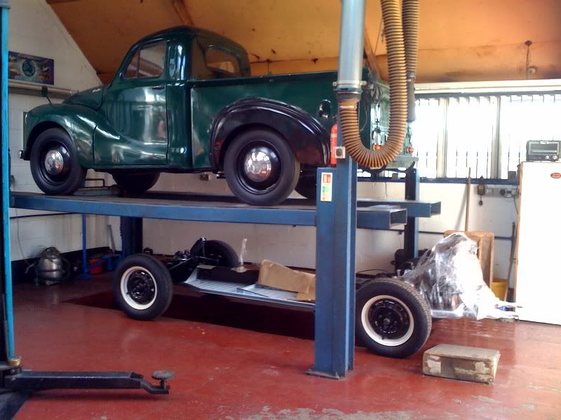

a pic of when i rediscovered it a few years ago, on Brighton seafront, shame those pressed number plates arent still on it :cry:

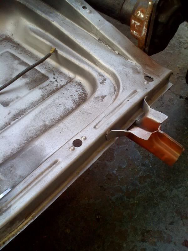

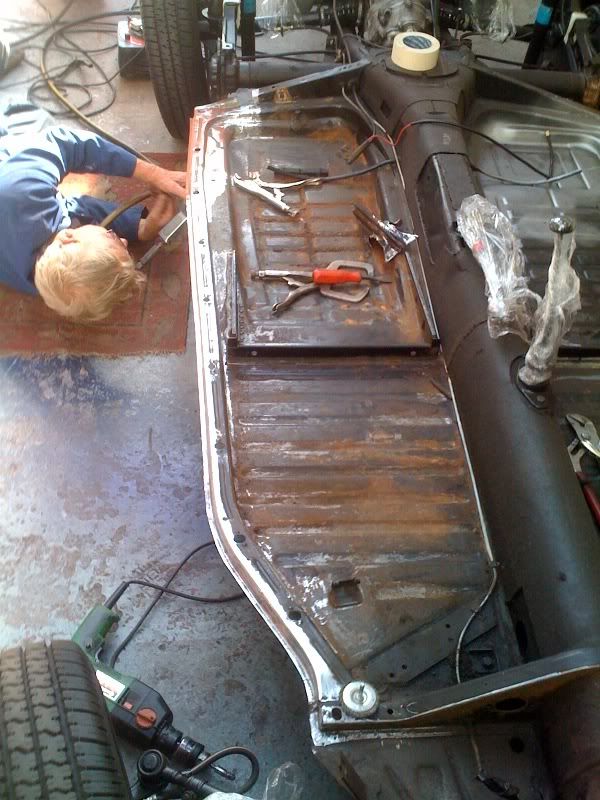

well been down to my mates classic car restoration business, whos repairing edges of the floors. got busy with the power file, and started to bare metal the surface rust areas.
this is the passenger side all solid, bit of smoothing, some paint and its done

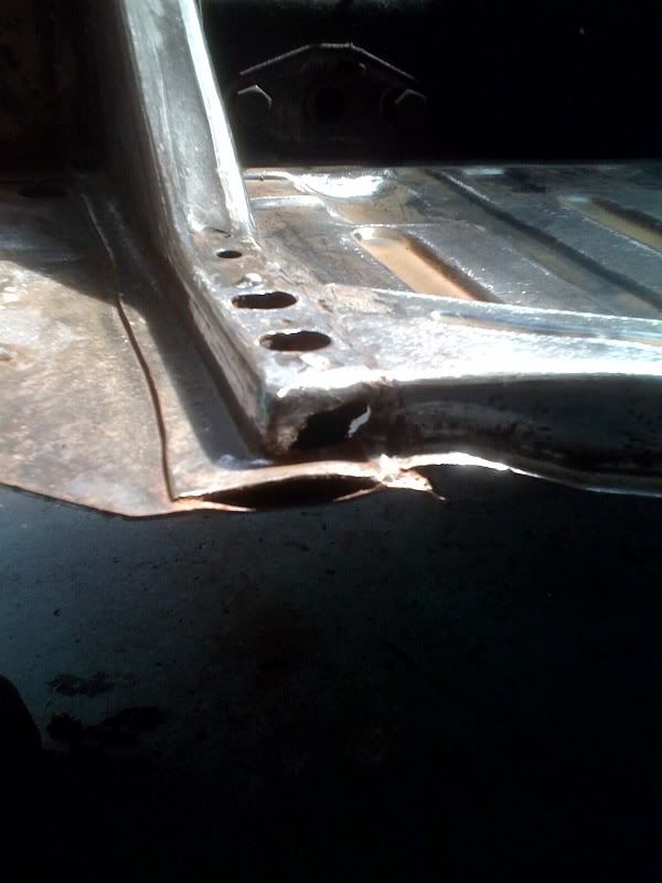

drivers side was worse, especially as some botcher had got to it previously, but looking good, little more fettling tomorrow

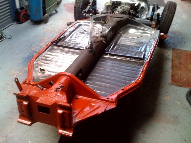

more progress, drivers back corner of the pan all finished, and both pans have been sanded and cleaned up ready for paint. The underside has had some flakey underseal removed, and will be painted and re-undersealed tomorrow when the chassis is on the ramp.

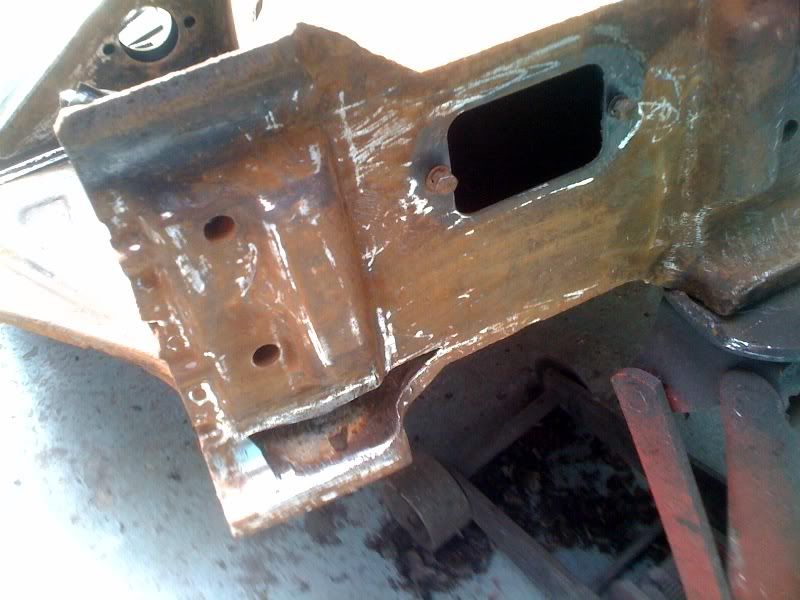

some mre nice holes were found in the framehead, so these were dealt with

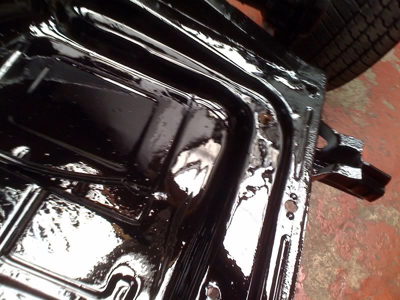

and finished off the framehead with some red oxide, itll get another coat in the morning, before being schulz'ed. and painted black.

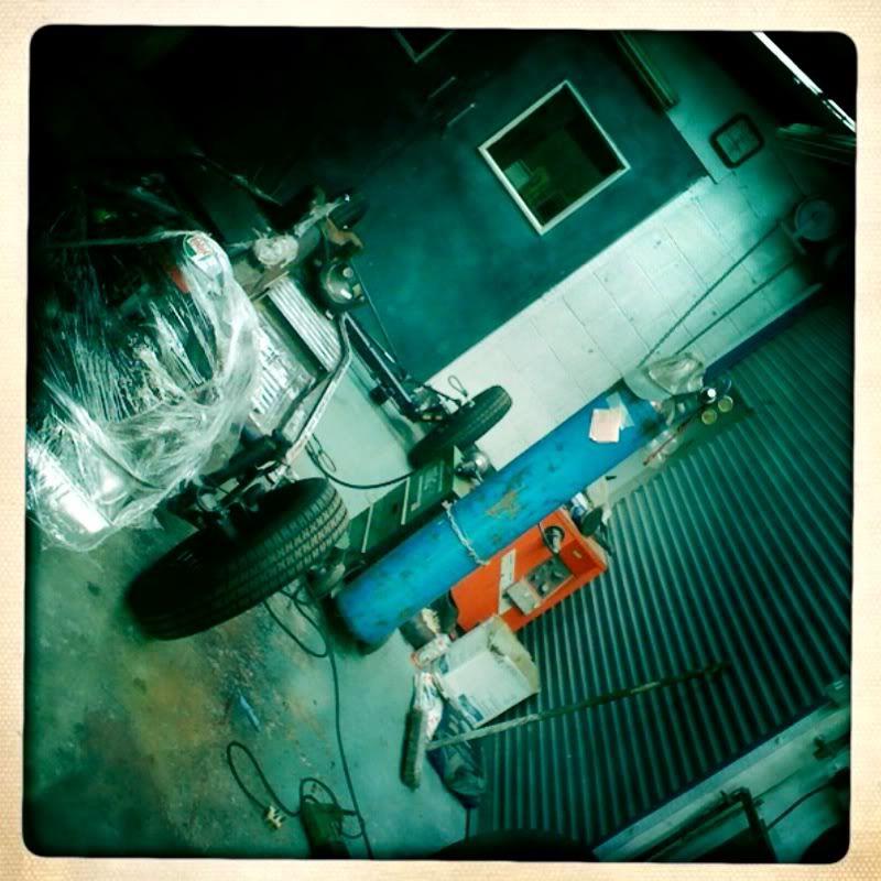

and an arty one to finish off

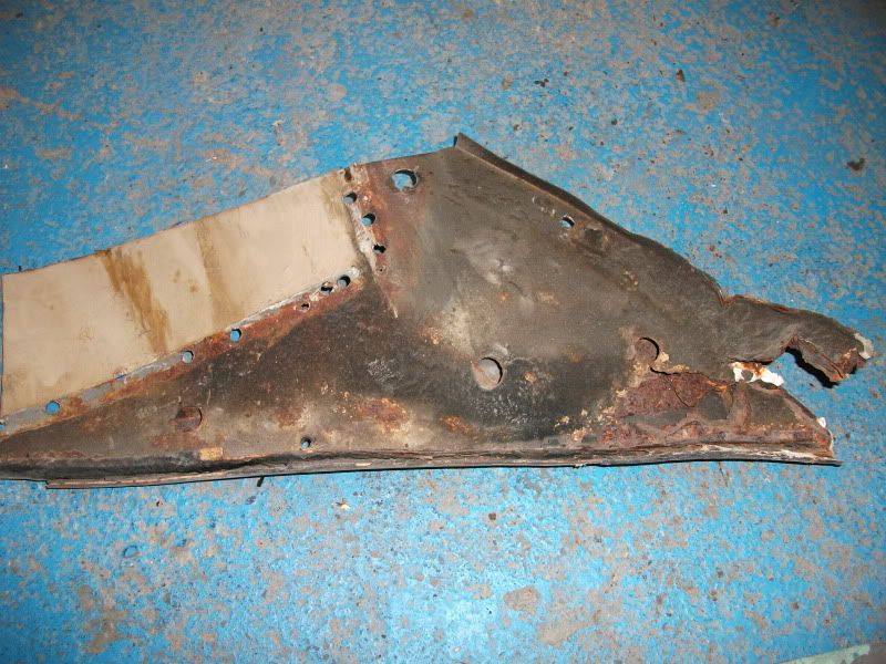

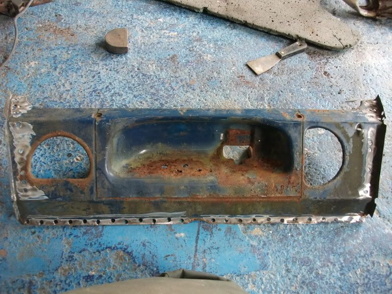

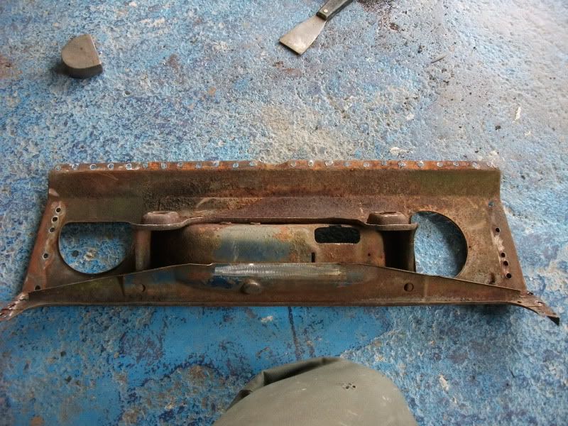

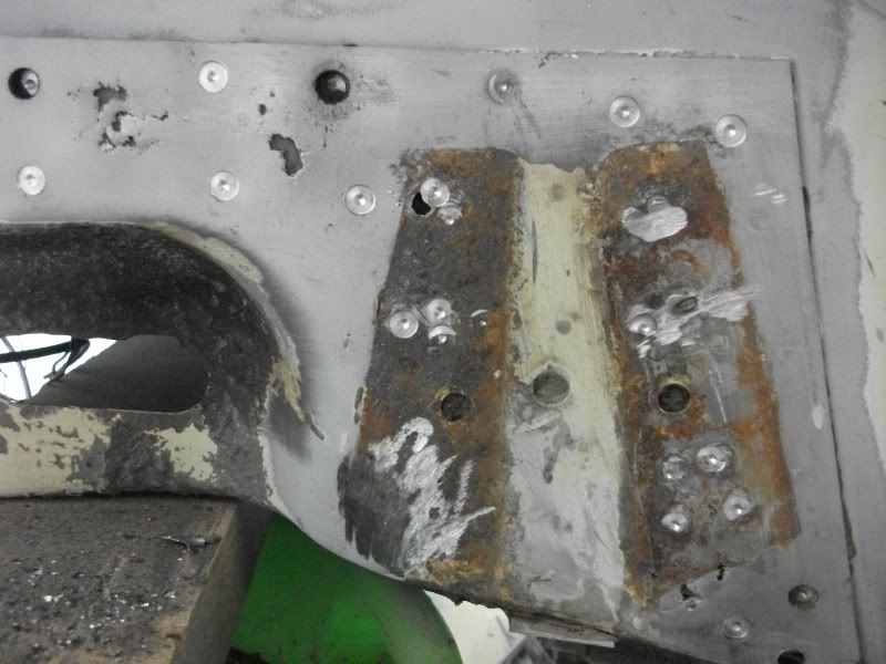

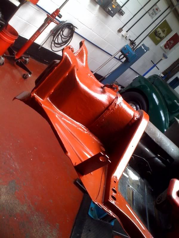

Hes spent a little bit of time between jobs unpicking the old inner front panel and the new panel ready to get blasted and fit.

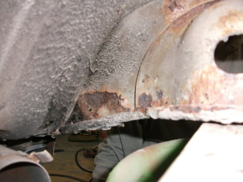

The top part of the spare wheel well is rusty too, but fortunately the new section has that part still attatched to it so he will repair that bit too before the reservoir panel is fitted.

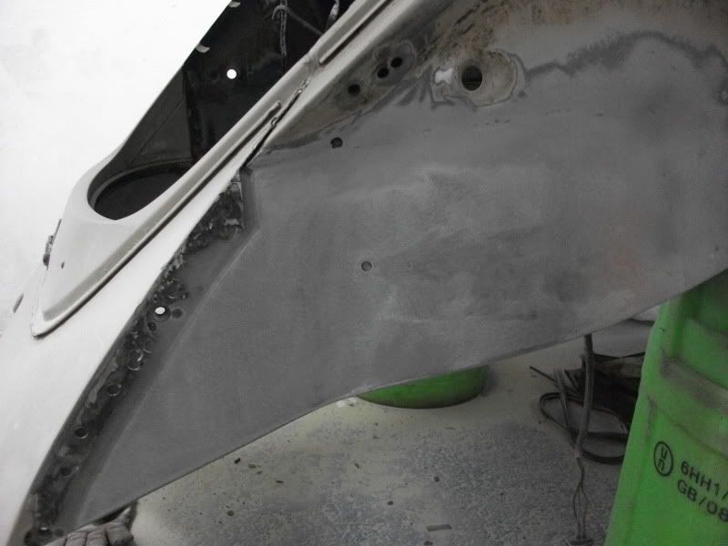

Gav has also started unpicking the rusty bumper mount on the drivers side ready to fit the new hooky panel. Once thats fitted the new/old bumper mounts will be installed following with nos valance.

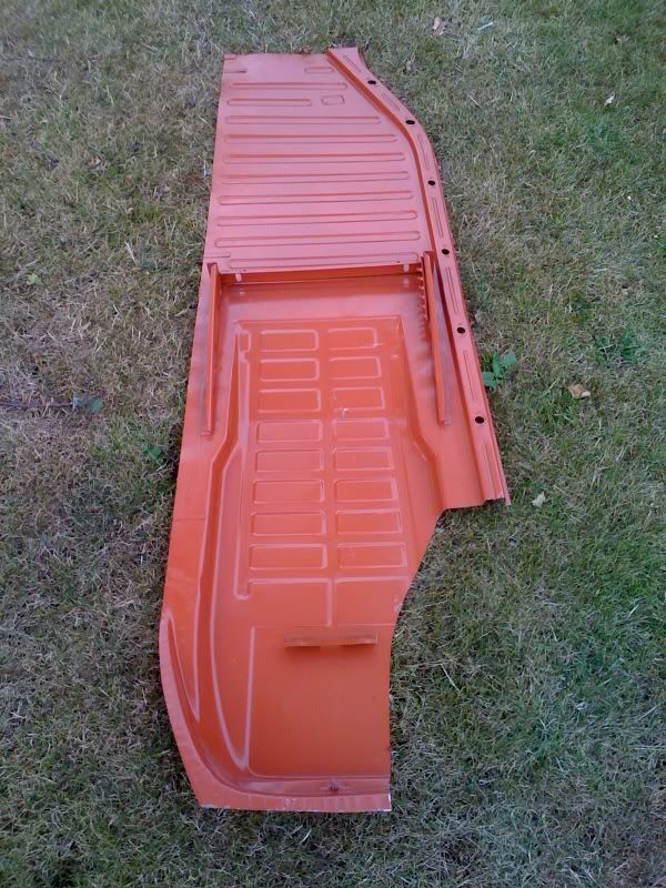

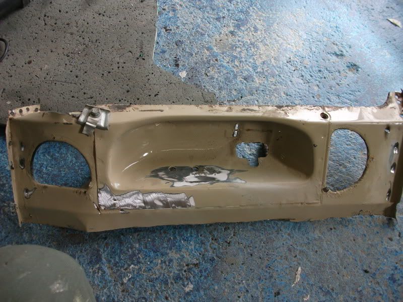

heres the donor panel i sourced
not full of filler or fibreglass like the old one ;)

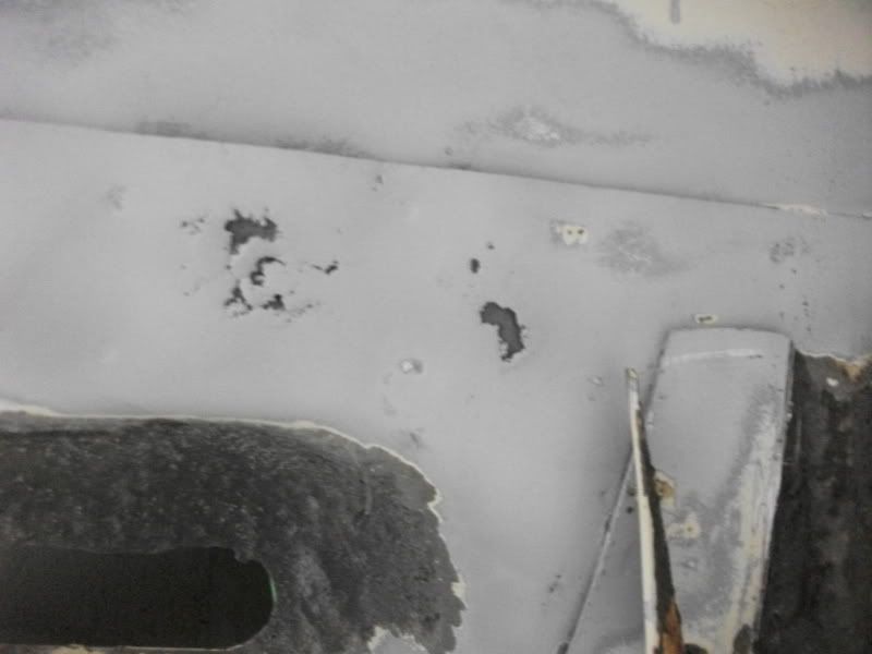

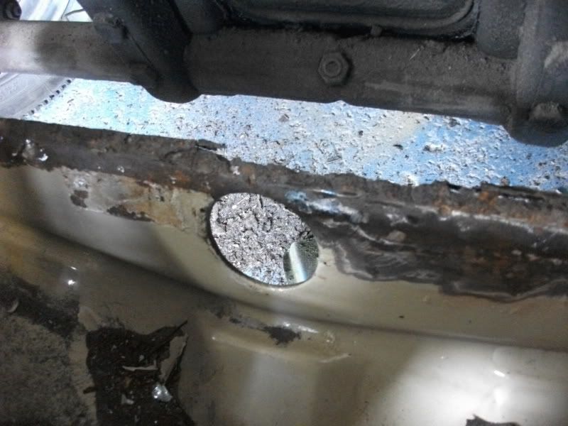

the old one cut out
Rust section, top of wheel well
Donor section to be let in.
more soon

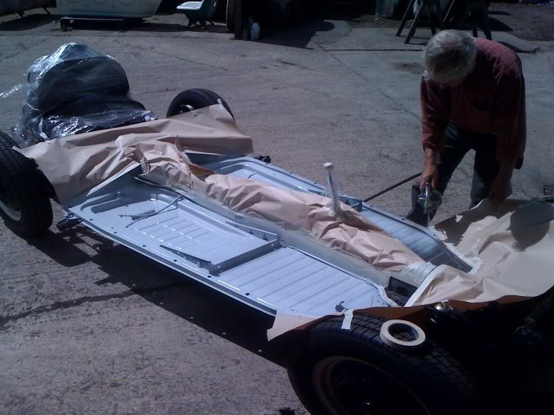

pan rolled off the lift to be masked for the topside to be 2k primed
all primed and left outside to bake for a few mins
Unmasked and sat ready for some 2k satin black on monday, along with final assembly of the restored pedals.

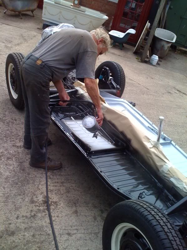

ha ha, thanks Martin, well the pan will be 2k blacked tomorrow, so will be all finished after ive refitted the restored pedals. 😎

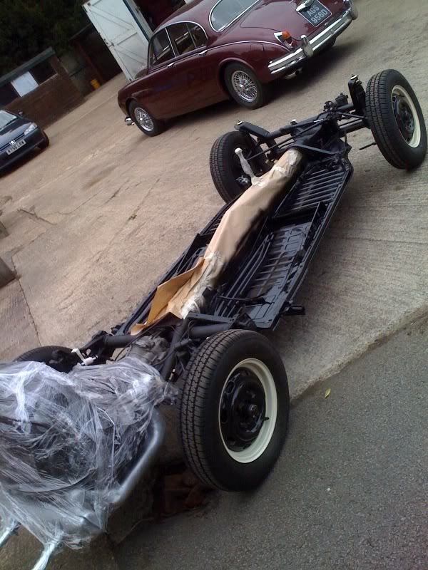

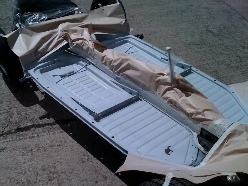

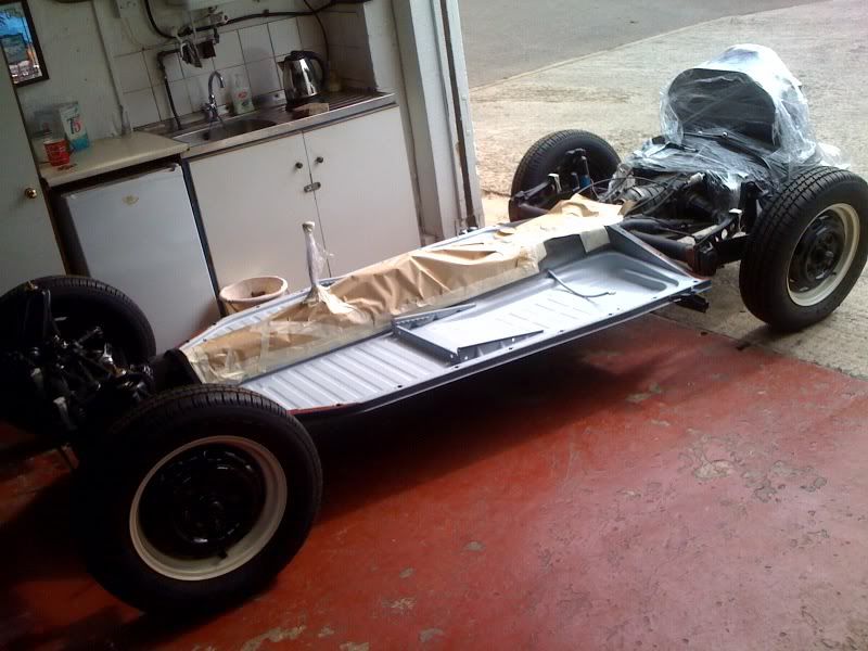

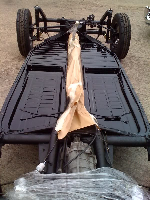

well another afternoon on the chassis. masked up ready for the top coat of 2k black with a slight matting agent to make it look factory.
the repaired corners
all done, just gotta fit the pan seal and the restored pedals, and its time for the body :)

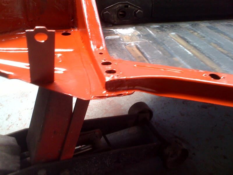

Gavin at Trailer Queen Restos is really cracking on, heres the drivers side bumper mount area....
old cut out
and the new hookeys panel all in place

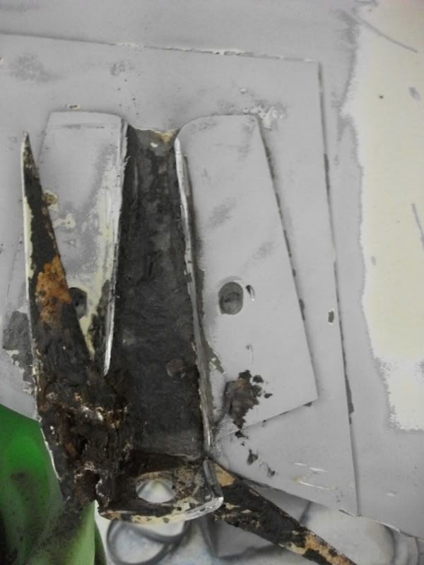

then onto the body mount in the rear drivers inner wing......
as per the pass side, theres a section cut from a cali car that will be let in here. The repair panels you can buy for this area are far too flimsy. more soon.
