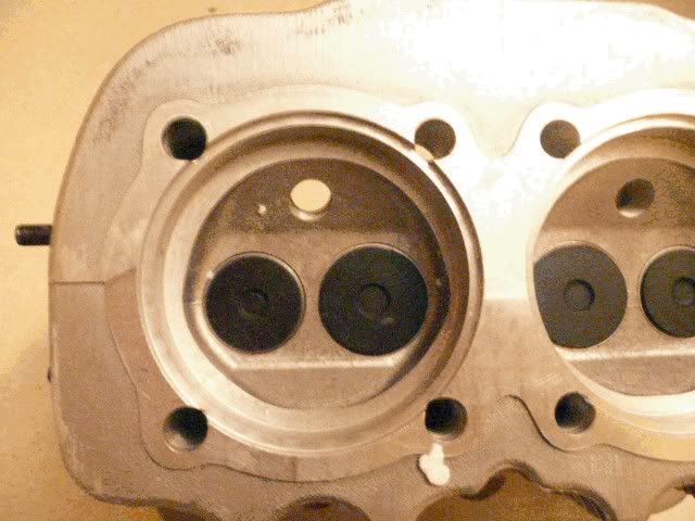

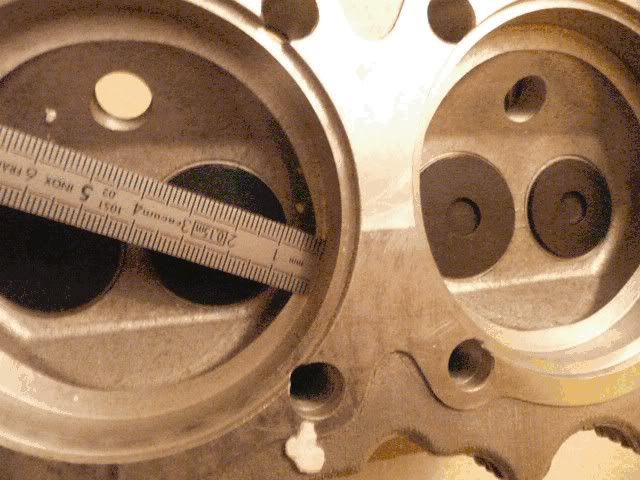

My friend and engine builder Eric recieved the kit some days ago and it was obvious that there was some kind of defect with the heads. The shoulder that the top of the cylinder was supposed to seat on inside the head was, at one point, only 1.5mm wide.
This is certainly not enough material to provide a decent seal or to prevent it blowing by in very short order.

Already posted there. It´s unfortunate that the photo with the ruler is at a bad angle - makes the measurement look bigger than it is and makes me look like a moaning git! I am promised some better pics over the weekend.
No idea if its a quality drop off, or just a duff one that nobody bothered to check. Some people have been happy with them and others less so, but mine is IMHO unusable as is. This measurement on an original Okrasa head is supposed to be 2.3mm, which is also a little close for comfort. If WW really spent so much time and effort on re-creating this kit as they´d have me believe, then why on Earth did they fail to notice and correct this?

A clearer photo of the "within tolerance, defect free" head.:x

1.5mm wide? - That makes them a VERY accurate copy of many the original heads. I had my NOS heads welded up to add some material for the same reason.
From the pictures, there's plenty of metal on the other side. It might be they have rather slack tolerances when machining for the cylinders.

Worn ruler or not ,its plain to see 1.5mm .You have every reason not to be happy .That kit is not cheap and another example of problematic repro parts.Worst thing is ,it not only dents your wallet but your enthusiasm for the hobby.After recent experiences I rarely buy any parts now without seeing/measuring them first .

They offered me my money back, and have also offered to pay the return shipping costs, which is nice, but I´m going to keep the heads and make them work. They may not be right, but they are the only game in town. Eric tells me that a couple of the valves leaked a little too. Makes me wince to think of people bolting these straight onto their engine, right out of the box. I know that´s what you should never do with engine parts, is to use anything without checking it carefully first, lapping valves and so on, but some of the replies on thesamba really make me wonder. Seems like there are few time bombs under construction!
Original Okrasa heads would be great if you can find some that aren´t cracked and can afford them.
