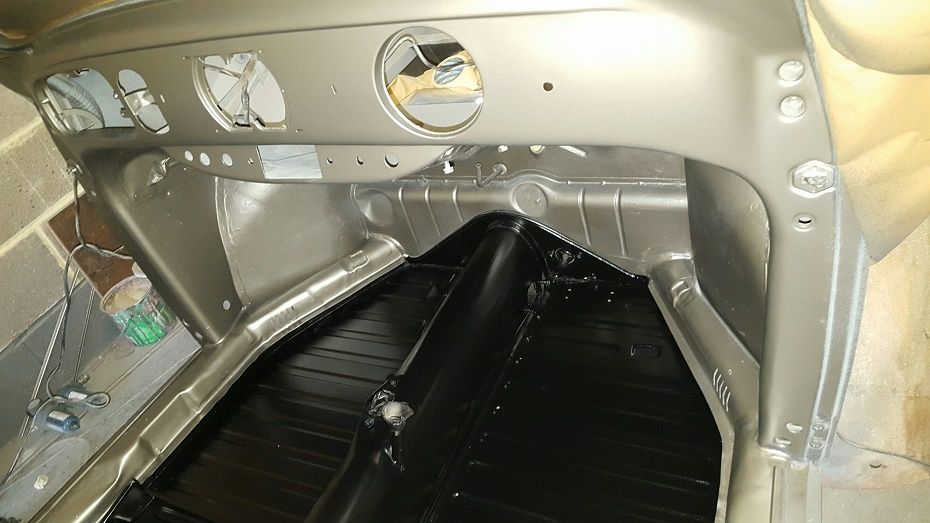

Engine Bay Tackled, now solid again.

Love the metal work, coming along nicely.
