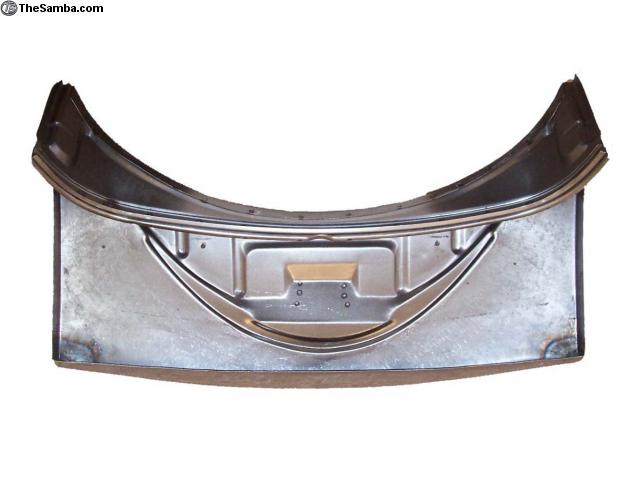

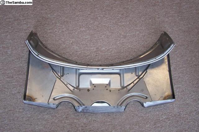

I was given a 'H' valance for the car, but is a later model type with cut outs for the exhaust. The plan is to have the cut outs welded over, but there is what appears to be a strengthening panel behind the cut outs. Sorry but I don't have any pictures to sow what I mean :roll: Is there any such panel on the earlier rear valences ?
Chris wrote:
I've got a 54 and there is not a strengthening panel on mine. I think they started doing that with the introduction of the double peashooters.

Next question, still regarding the rear valence. Are there any 'dimples' on the bottom of the valence ? The picture Rob posted of the valence doesn't seem to show any, but the angle is wrong to really see. Here's a picture I was sent which clearly shows four 'dimples' on the valence. Can anyone verify if these are correct for a 1954 model oval ?
Once again thanks :d
