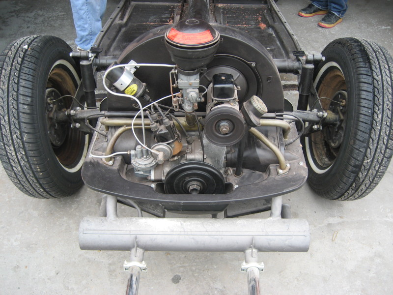

Hello, I don't want to sound rude, but you have asked for opinions on the problems... I really urge you to take that motor out of the car and give it some serious TLC, the wiring and the rubber fuel pipe look like a fire waiting to happen to me.
I would suggest checking the soundness of the intake manifold, I would throw the Mexican dizzy, coil and ignition leads in the bin. You should be able to source a correct German bosch dizzy and coil pretty cheaply through the forum ads.
I would also check all valve clearances and run a compression test, the little 30hp motors run sweet if they are in good order, but that looks like a combination of many problems to me, not just one thing.
I reckon an investment of £100 ish and a couple of days graft and you could get that running (and looking) sweet 😎
BTW the carb you have is correct for a '58 1200 but it's not a 28pict it is the 28pci with the manual choke...the pict version has the automatic choke.
It also looks as if you have some missing bits of engine tinware. You need to have it all to keep exhaust heat from adding to the engine heat between the top and bottom of the engine.

Take some tools with you and do some diagnostics when it refuses start, you need fuel and a spark. Take the top off the carb and check the float chamber has fuel in it, take a spare spark plug with you - pull a lead off and put on the spare plug, hold the plug with plastic handled pliers and thick gloves and earth the plug while someone cranks the engine over for a few seconds - you should see a nice spark.
If you have no fuel it's most probably a carb problem, if you have no spark then it's a case of tracing it back to see what's going wrong.
