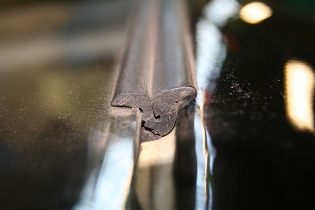

Here is a picture of a "never-been-out" original rubber profile in a 1954 curved screen Beeskow. It is torn on the inside of the window, but otherwise look very very similar to the repro profile in the post above. Note how the "double lip"-sealing principle against the body is packed and tucked.

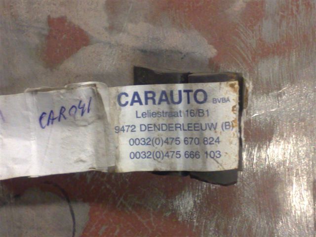

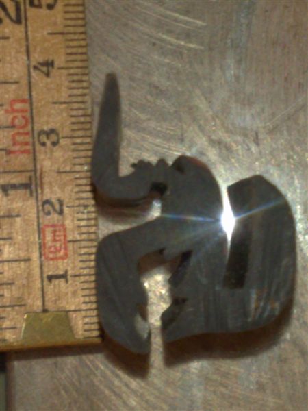

3) I have collected numerous samples of very similar rubber profiles from period correct other European cars...being reproduced today by 2 companies in Germany and 1 company in Holland. These are high qulaity reproductions, very nice profiles.. I basically fetched about 30 profiles that was very similar to Rometsch and have tried them on my curved screen Beeskow car. One of them fit very very nice and is very similar to the original Romestch profile...except it has "multiple-grooves"-sealing principle against the body (like original VW), instead of the "double-lip"-sealing like Rometsch. Visually it is very similar, although a little bit wider. I am awaiting full length sample of this profile and will try it with glass and chrome and publish the results.
Here is the profile and part number:
(I will make and post a better profile pic later)
From this company in Holland:
https://www.carauto-oldtimer.be/en/index.html

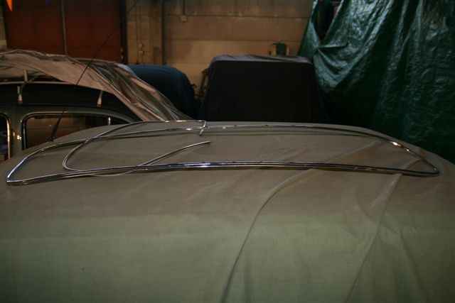

Some input: THE CHROME PROFILE - ORIGINAL
Here are some pictures of an original windscreen chrome profile from a 1954 Beeskow. It is a fully pre-formed, welded brass profile that has been chromed.
I tried the scetch the profile in red on the bad picture at the bottom. Unusual, hard to make piece this...
The visible part of it is about 12 mm wide. Notice how it is shaped...meaning that all of the visible area of it will fit to the inside of the groove in the rubber...i.e. not central in the rubber profile.

Here is a picture of the profile I have identified as very similar to the original. Part number and supplier as above.
It is the first time I am able to compare to it to an original - as in overrestored's photo above. It is very very similar, I feel confident it will work - and as soon as I have my full length order here I will prove it. The alu strip above will also fit this profile.
Total visible width is about 35 mm for both. The major difference is that were the original has "double fat lip"-seal against the body...the repro has "multiple small ribs" as on original VW rubber.
