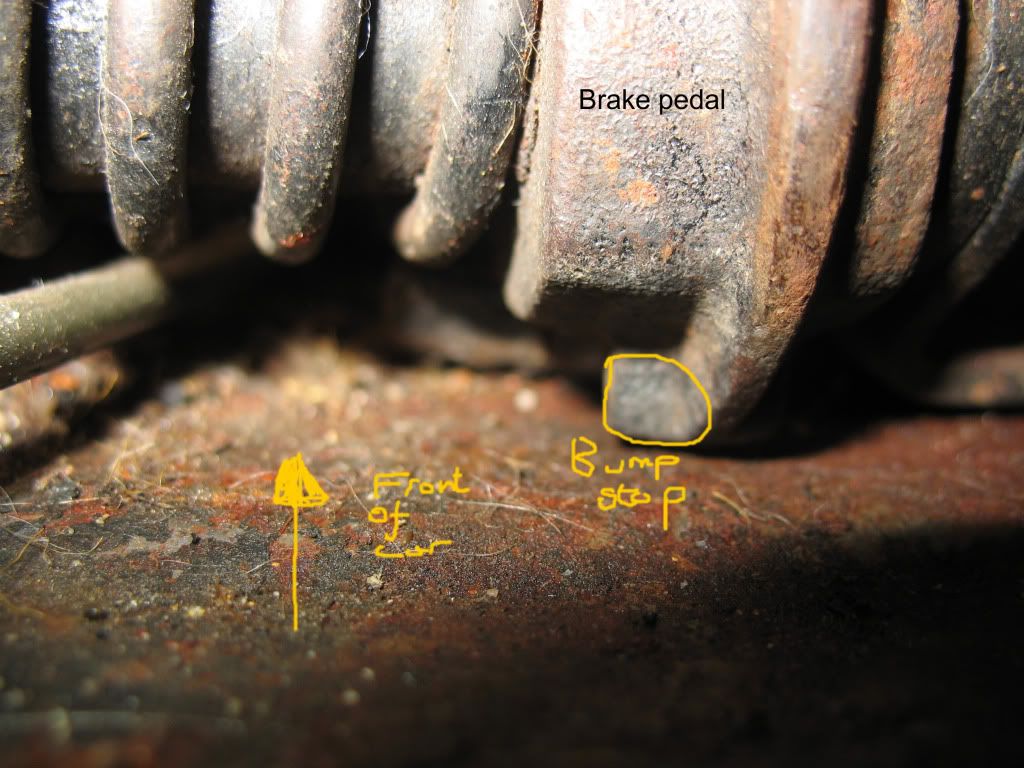

Circled in this photo just to give you a rough idea is the cast bump stop on the brake pedal. Also from an oval ('55), I know this as I've just taken the photo....
