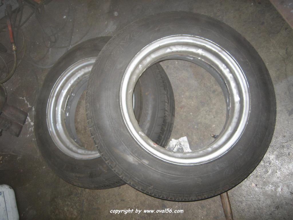

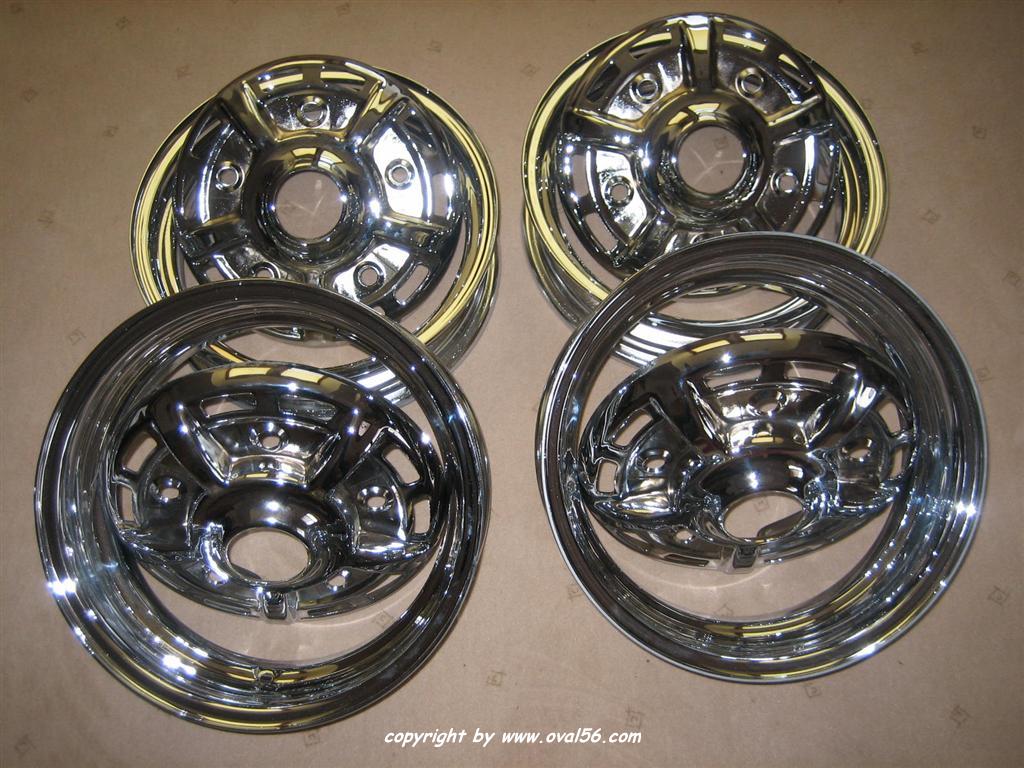

so know i need my rims to drive it, but they are still at the welder :? :cry: :cry:
Wow! Damn!! Can´t wait to see how it runs.:beer: 😎
Whats happening to your wheels to need welding?
me too James :lol:

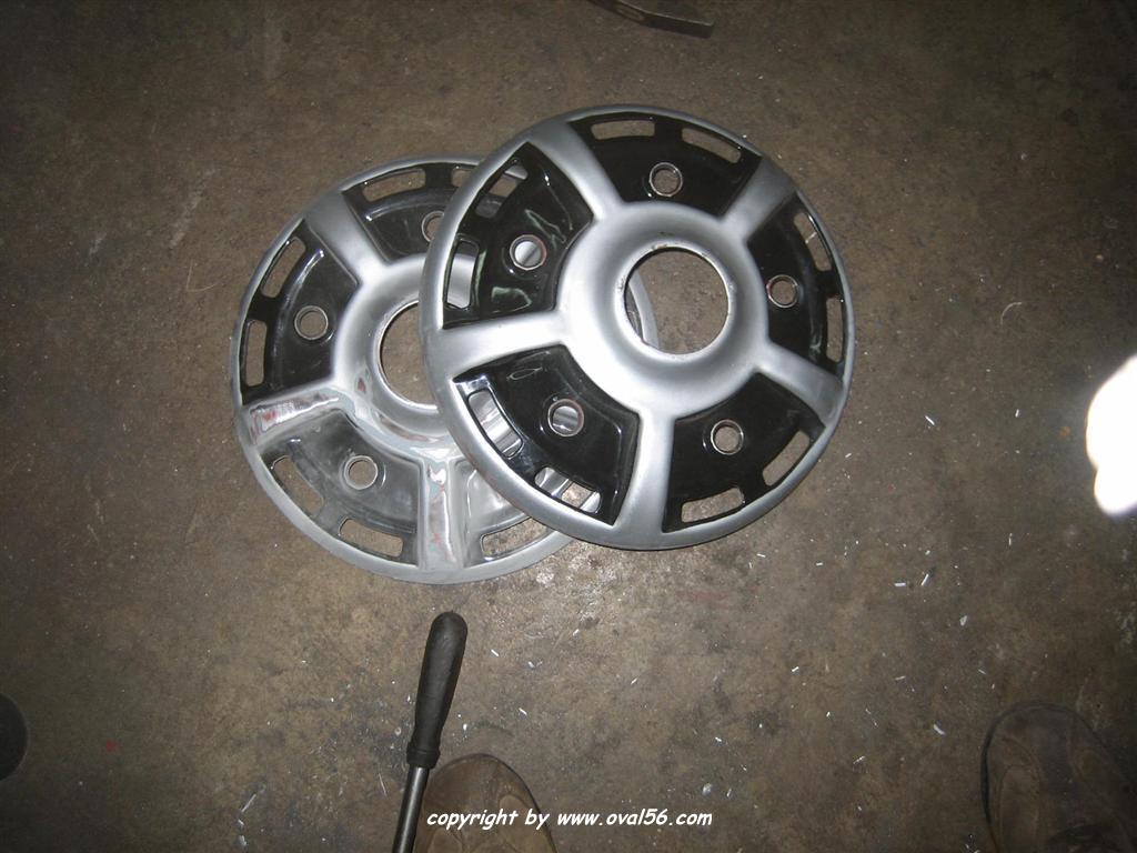

after the fact that i used my spare rims and 2 painted ones for the heb (only for the feature in HO'09 i tock my chromed set from my 57) i was forced to do the chrometreatement on an further set....
and now the are at backwelding the centers... he has prommised to shipp it this week and i hope i get it until friday :-)

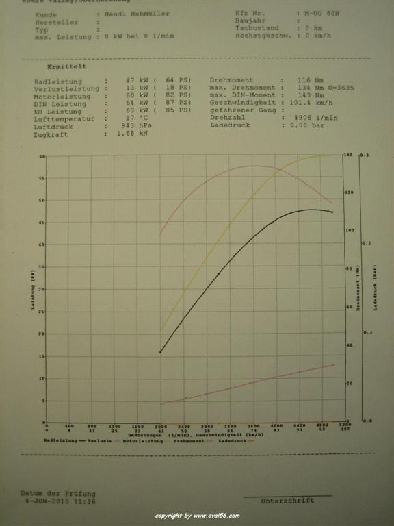

...and finaly on the dyno after 3500kms...
sure, carb setting could make some minimal improvement to get the 90ps, but it runss great and i will not change anything at the moment...
that is my face looking at the moment::d :d

printout:
JOB done, so what is next :idea: :? :?:
