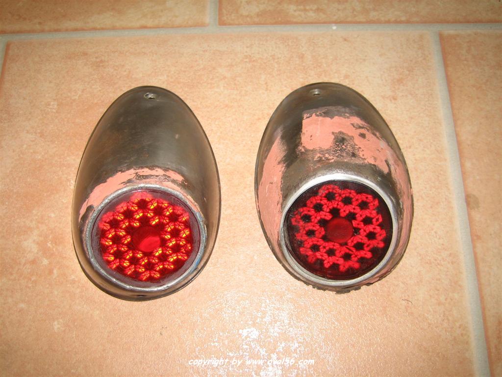

now i got a real shitty set of original taillights, where a expert was on before i got them... :evil: :roll: :lol:

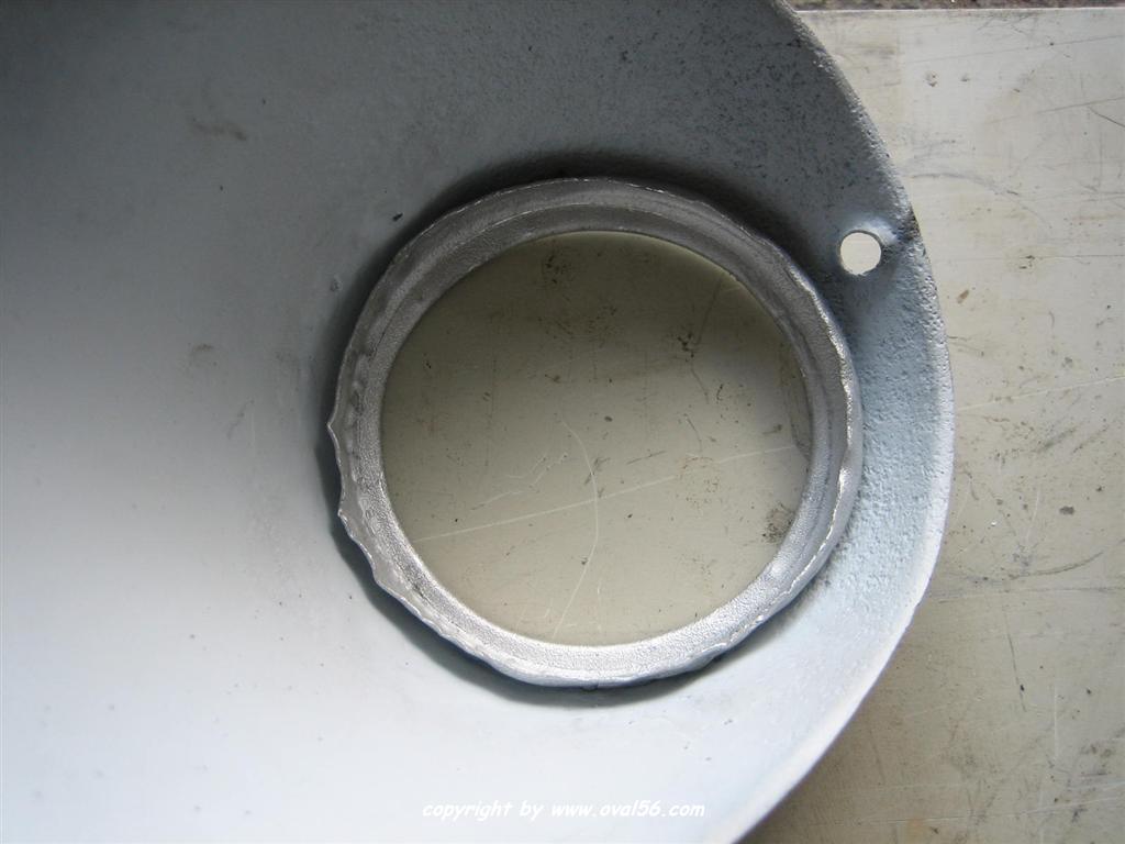

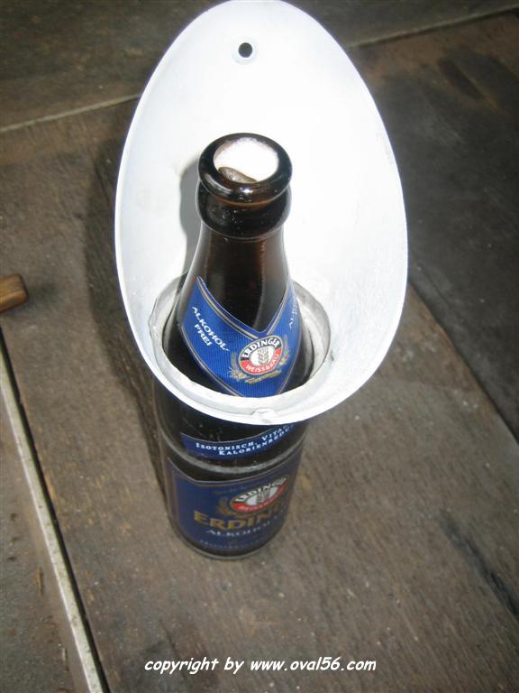

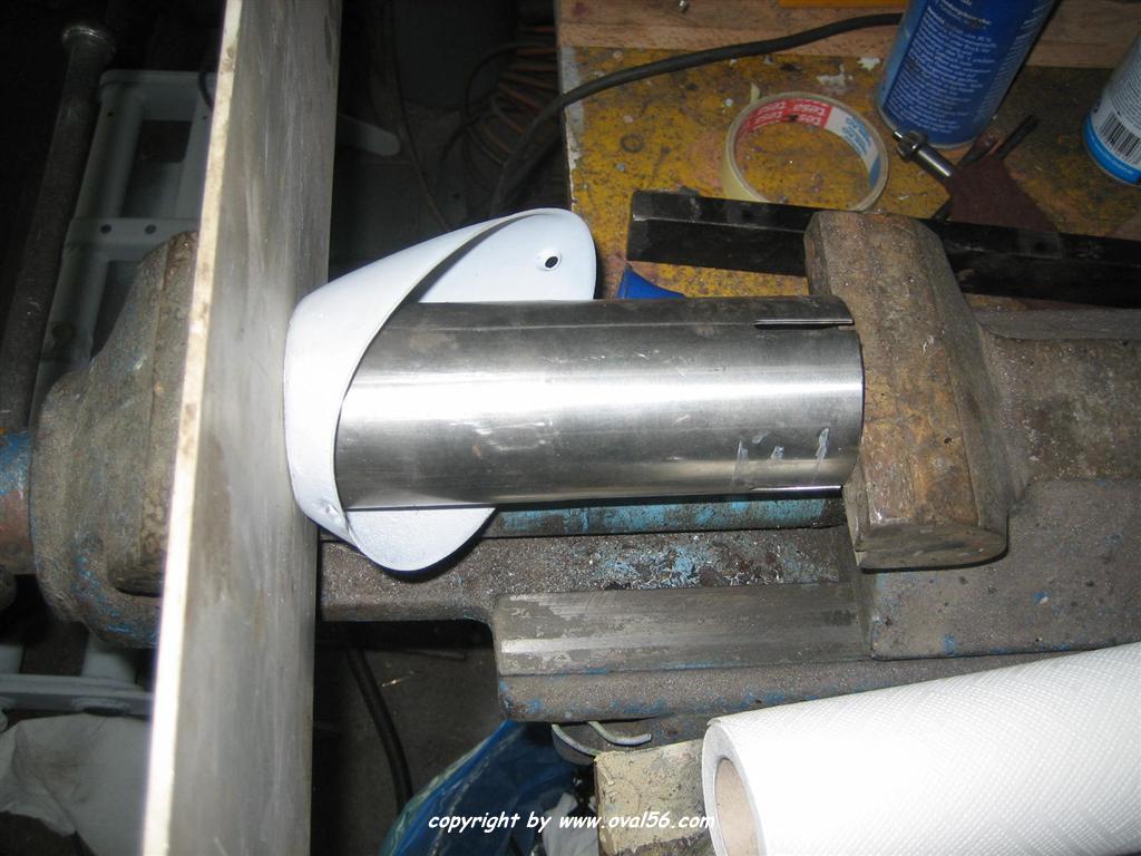

restoring pre50 backlights with alutrim:
1. buy chaep but real shitty original rearlights:

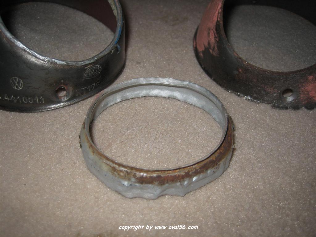

2. remove the trim carfully! or the rest of it.

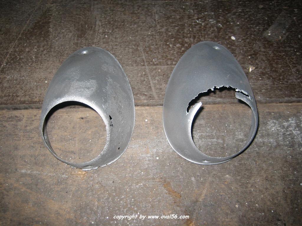

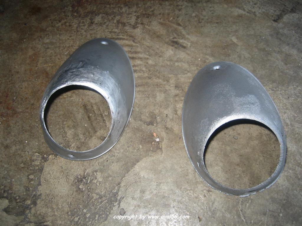

3. blast them and see what a "bondoguy" hase done to it.... :roll: :shock:
4.weld them and put the ring back,
5. the best and the main part: drink a bottle of german beer, and use the bottle to fix the centerhole right!!! :lol: :shock: 😃

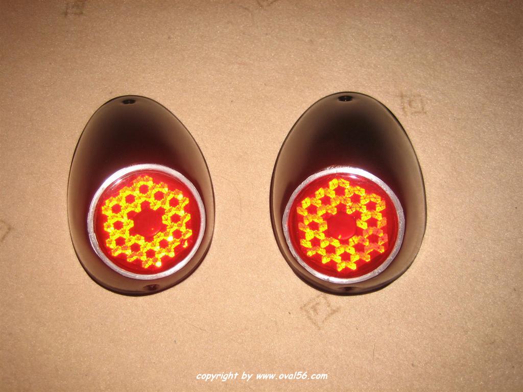

6. last but not least... paint them...
i know, the right one is not perfect, but it is okay for the "ratmuller" :lol:
the special bavarian rearlight alutrim fixing tool is availible and in stock with different tastes :shock: :lol: :beer:
