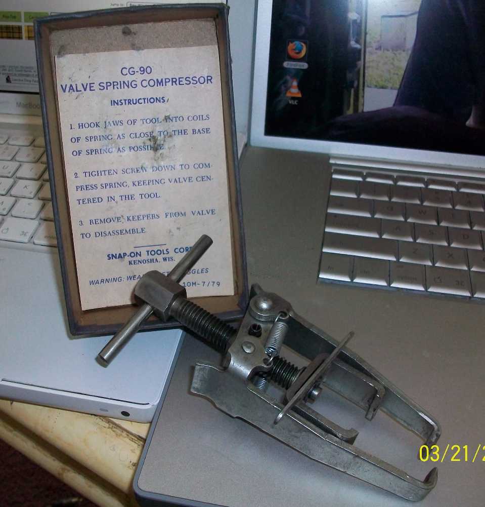

Think its time to use this
quick question, arent you supposed to bench bleed the master cylinder before fitting?
Last Triumph
opl505e wrote:
What is that??
